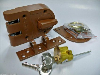

I was wondering what is thought of as better security for a front door... a standard deadbolt or a jimmy-proof deadlock?
I am renting a place in the Southern CA area and have a Schlage deadbolt but I was thinking about adding (or replacing with) a Yale jimmy-proof deadlock such as this:
Any thoughts?

The jimmy-proof lock, properly installed, tends to be much more secure from forced entry than a deadbolt. However, as that is a rental you are referring to, you should check your rental contract and with your landlord to be sure that it is permitted for you to change locks. Many rental contracts do not permit the renter to change locks. At the very least, the contract will require you to give the landlord a key.

I might see if I can maybe add it and key the same with a Schlage rim cylinder.
Then again it's drilling a new hole in the door so I don't know if it will fly haha.
It's at least good to know that the jimmy-proof lock is better security.

Not only drilling a new hole. The Jimmy Proof lock requires a fair bit of work on the frame too.

Just one man's opinion: To make one really secure you'd need some kind of armored cover for the rim cylinder, along with screws that go nearly all the way through the door to mount the chassis. For the strike, I'd use the longest possible screws I could-like 3 inches or more.

I think you should at least install a decent, high security rim cylinder. Personally, I love the jimmyproof, especially what medeco has done with it,
The medeco bodyguard is lovely as well, as an outer lock accessory

When installing the jimmy proof, be sure to install long screws in the strike.
I sell the Australian made Lockwood 305 rim....which is significantly more expensive and much better quality than the Bird Jimmy. It is not a strong as the discontinued Abloy Super-Stopper, but looks good and works very well. The rim lock is installed to the door with 6 screws. And the strike is also available flanged, so it wraps around the jamb increasing the strength of the fitting

globallockytoo wrote:When installing the jimmy proof, be sure to install long screws in the strike.
+1 on that. Remember, all the screw on locks are only so good as well they are fixed to the door & the frame.
For reference: The ones which are only secured by 2 weaker screws each don't even withstand a couple of forceful kicks.
