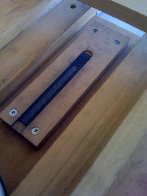

Router Jig, preparing to route a 1/2" x 4" blank of 1.7 mm carbon fiber sheet. (The jig took as long to make as the pick)
1/4" groove routed, 3/64" deep.
Another shot of the groove. You'd be amazed how hard it is to take pictures of carbon fiber.

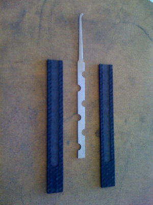

Roughed out pick and handles, ready for lay-up. The half-moon shapes are to help the epoxy surround the pick, and hopefully help prevent delamination. (And it was a nice excuse to use the new Oregon chainsaw files I picked up, which the dealer just gave me for free when I told him what I was using them for! Score!)

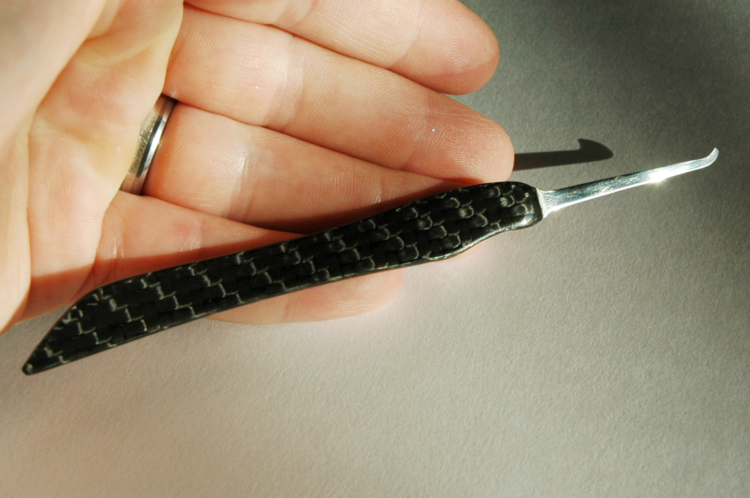

Pick epoxied, shaped, and roughly polished. It's amazingly hard to take picture of this stuff. My three year old describe it best as "sparkly" (Oh, and I used a real camera for this too...)
I still need to polish the pick itself. (Right now it's around 600 grit, I like to go to 2000) I also want to clear-coat and sand the handle. I'm a little nervous about this step, since I haven't done it before, and don't think I'm going to spend the money for proper airbrush-applied top coat.
The stiffness and lightness of the handle give the pick really nice feedback, and I'm hoping that this is the first in a line. I'll post more as I get more done.

I built the grooving jig because I couldn't think of any other way to make a precise groove, and I didn't want to use the router inverted in a router table, since I figured it would be dead in minutes from ingesting dust. (CF dust is electrically conductive and VERY fine, so it will kill anything motorized if given a chance.) Sadly, I will have fully depreciated the 1/4" bit in another 5 or 6 sets. :( I also was building a jig to cut the sheet into 1/2" wide stripes using a mounted rotary tool and cut-off wheels, but decided to sacrifice a blade in my miter saw instead.

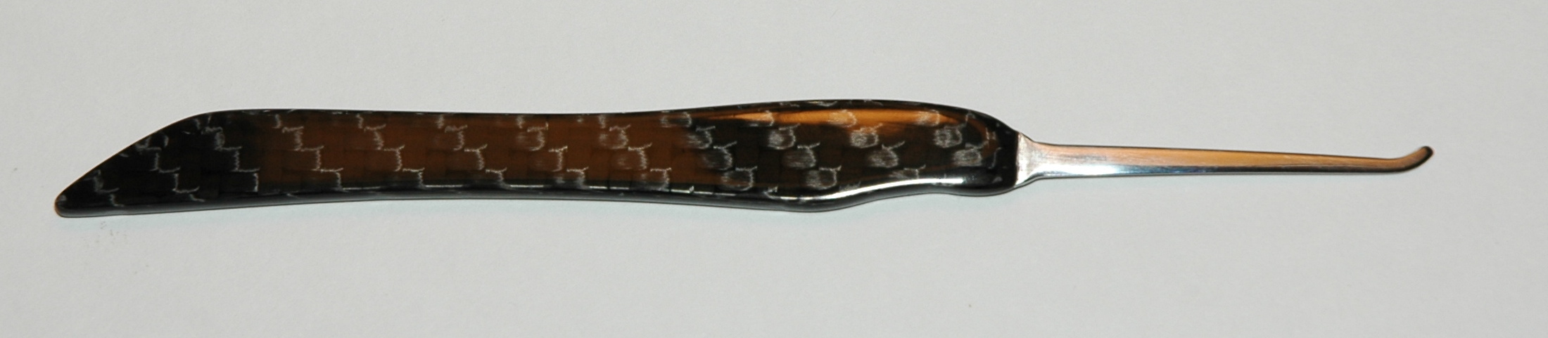

I got some automotive clear-coat in a rattle can today, and did two coats of it. Unfortunately, I think I misted a little bit too thick on the second coat, so I'll need to sand before going further and posting pictures. (But it is looking really, really nice if I do say so myself)

I sanded down the lacquer last night, and resprayed it, and it looks stunning, except for the nice drip I managed to get in the last coat. Grrr.... I expected the lacquer process to be a pain, and it is certainly living up to expectations. :lol: The results seem worth it though. (And if I keep doing this, I think Rift's suggestion of a real airbrush is going to be required)

I finished the clearcoat last week, but never got around to posting pictures. Taking pictures of shiny patterned stuff sux. :lol:
