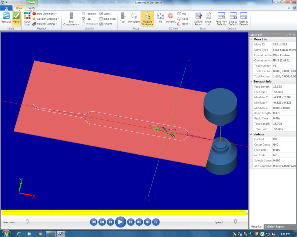

Postby YouLuckyFox » 20 Jun 2014 18:02
Here's what I've got so far, the dotted line there will not be cut.

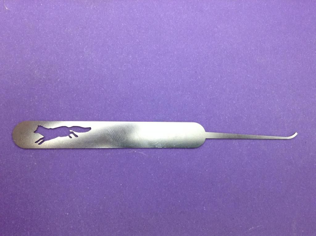

Postby YouLuckyFox » 23 Jun 2014 23:00
Here it is!

Postby 1mrchristopher » 23 Jun 2014 23:02
Nicely done! Now you should make a deForest to match ;)

Postby YouLuckyFox » 23 Jun 2014 23:35
I don't have really anything else planned after this, I've decided against press fitting a copper in-lay of the fox into the pick, mainly because it would be too finicky with such a thin part (plus getting the feet would be TOUGH!) The next projects are a lathe project, a nameplate with my sons name and a baby bottle etched in (using the end-mill) and a wood plane that is machined to 0.0001" tolerance (not a wooden plane, but a plane for carpentry work,) and I want to have as much time as possible on that wood plane! Now that I've done it once, I've learned I can stack several of these in one pass (up to a stack of over 4 inches!) to make a whole bunch of lock picks in one go. Anyway, here's my summary, hope this benefits someone:
Advantages:
You can stack these and do several profiles in one process
Extremely tight tolerances
No burrs whatsoever
Goes through anything that conducts electricity, being very helpful on hard to machine metals
Disadvantages:
Not a cool process to watch
Very slow, this part (speaking of the pick as a "part") took well over an hour to complete
Even as small of tolerances as this can do, the initial arc leaves a bit of "arc burn"; ideally this would be at the very center of a profile that would not be included, or the arc would start outside of the part (in this case a hole was drilled to start the wire at the center of the fox, but it still left a bit of arc burn--could have been fixed by more careful preparation work with setting up the fixture)
Because you are often only making one part, you don't take the time to set up a thoroughly locating and constraining fixture, which can cause accuracy to suffer.
For every contour you make, you must either start outside of the workpiece (so that the wire can thread and cut) or make a hole for the wire to thread through (this is why I ultimately decided against a key fob)
ALSO, any closed contours would obviously be cut out of the part, so a closed letter like an "O" would need to be especially designed to remain linked to the workpiece somewhere
A clarification on the original post in this thread:
I ultimately decided with 0.025" 301 Stainless Steel, I referred to it in my top post as "a spring steel" though 301 Stainless can be tempered to "spring," I did not mean to imply that any form of 301 would be spring-steel. 301 can be found in a range of hardnesses, but I did indeed order it in "spring" temper.

Postby GWiens2001 » 24 Jun 2014 0:39
YLF - that is outstanding! A real work of art.

Postby NinjaLlama » 24 Jun 2014 5:54
Well done! That looks fantastic.
