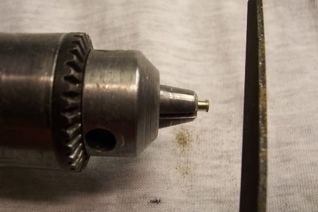

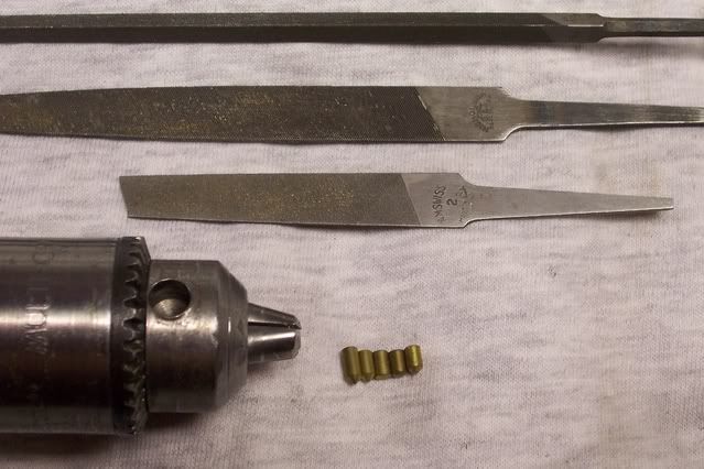

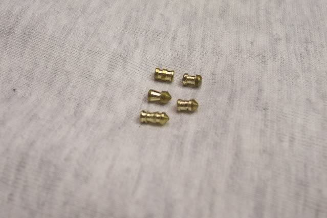

Simple security pins are easy to make. Buy them in large quantities from a locksmith supplier or directly from a local locksmith if you need an assortment for regular rekeying.
Doing this yourself can be fun. But, be careful and do not hurt your self using anything too sharp or too strong a drill.
These are samples of making security pins with a cordless drill, files and extra pins. A Dremel might also work well. All five took only about 20 minutes to make.
Original materials before starting.
Cutting one pin.
Same five pins after cutting.

Great job on those pins Raymond! I've never really thought about making my own, but that's such a great idea!
Very happy you brought this up as it opens up a whole new world of experimenting. I'm definately going to have to pull out a few locks soon and try this out.

cool, never thought of that myself, I just take apart old corbin locks for spools,

Hey Raymond, you made a very cool mushroom :mrgreen:

I know this thread is kinda old. But I've been using single sided razor blades to shape different security pins. You can get much more accurate cuts than with a needle file, also allows you to make serrated pins. Turned some otherwise easy locks into very evil ones.

Nice idea. Kind of like an extremely thin cut off blade on a lathe. I would need my magnifying goggles to see what I am doing on something that detailed.

Or make your own security pins. Take a regular top pin, chuck it in a drill, turn it at low speed and use a needle file to shape it into a spool, serrated, or whatever kind of pin you're looking for.
