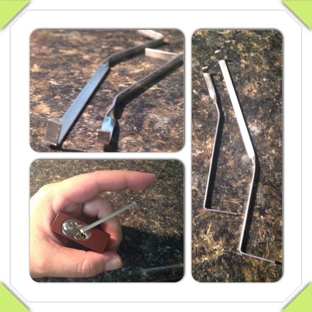

Postby Raymond » 4 Feb 2015 23:19
This is my #1 go to turning tool I have been using for over 20 years. It is made from a common street sweeper brush. I also use the same style made from windshield wipers and in several different sizes. I prefer the length of the tool to be flat because I can put a bend in it, by hand, at any moment of need. The length , twist, and other details may vary considerably depending on your personal need at that moment. There is NO one design that is always right.
The main point to see on this tool is the stepped tip. I have some stepped on one side and others stepped on the other side. They are used in different keyways depending on which way the grooves are. They are also used depending on which direction I need to turn the plug.
The step is a multi-purpose variation. On big keyways insert the full width at the bottom of the keyway. On tight keyways use only the tip. The step can rest on the front of the cylinder with the small tip turning the plug. This will prevent the tool from slipping under a groove/keyway-ward in the bottom of the keyway and wedging between the plug and cylinder. If this happens the plug is bound and will not turn freely.
The tip can be used at the top of the keyway and the step keeps the tool from touching a pin. Because the tip is only half the size it does not block access to the pins.

Postby KPick » 5 Feb 2015 1:32
Like raymond, I make my own tools as well. I usually file down the ugliness of the metal windshield wiper sticks and then I bend them to shape.
I prefer long tension wrenches because the difference in angle coming from the locks feedback is multiplied the longer the tension wrench is. My preference is a 4-5 inch tension wrench, double sided, one side made short for top of the keyway, and the other side made long for the bottom of the keyway.
I also carry various widths to compliment different locks as I work. Some are very thin in width, and some are thick and juicy for wide open hunky easy keyways.
