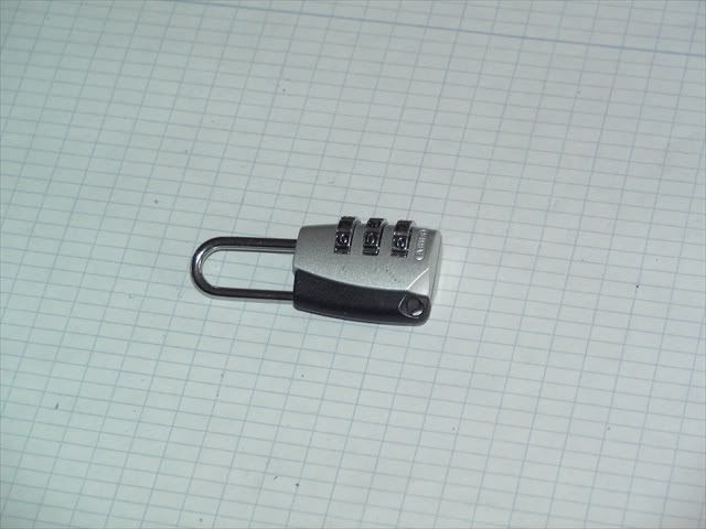

This is a Abus 155/20 I've taken appart a while ago.
I had sold it to a customer. She had tried to change the combination , but must have done something wrong. She came back to the store and bought a new one. I set the new combo myself this time. :roll:
Instead of throwing the lock away , I decided to take it appart , and see whats inside.
This is the lock itself

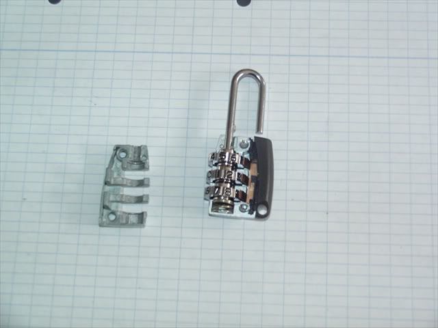

There are 2 rivets on one side , I drilled them out
Then just take off the cover.
You can now see the inside. Notice the spring under the shackle and the spring that holds the tumblers.

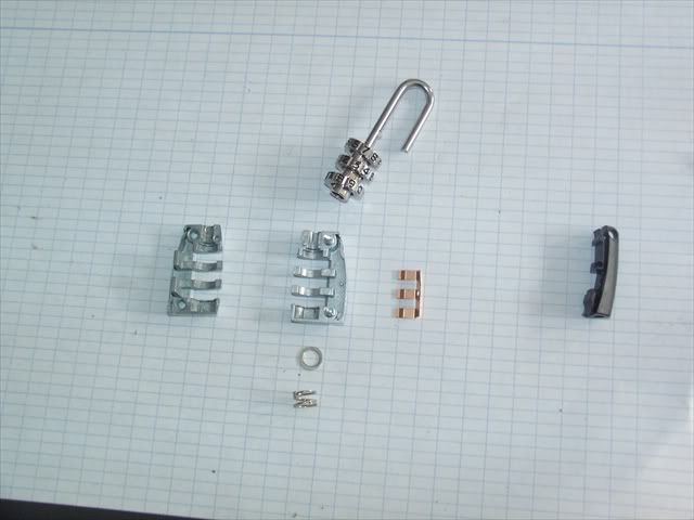

These are all the parts. I kept the tumblers and shackle together
These are all the parts that make up the tumblers and the shackle.

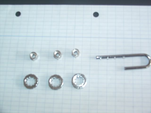

The wheels on the top of the picture have 1 gate for the shackle and have 4 pins on the outside. The pics are not equally spread. One of them facing the gate.
The wheel at the bottom goes around the top one. It has 10 gates , equally spread out.
I'm sorry for the crap picture. I couldn't get the camera to focus better.
