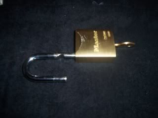

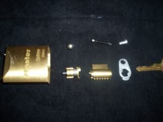

I made this lock a while ago,...I was bored and being creative. My goal was to make the lock easy to pick, but not easy to pick it open :twisted:

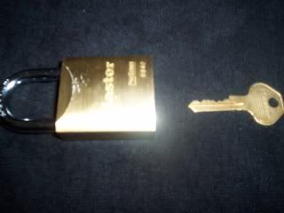

This is the lock and the key that works it.
Nothing too unusual at this point. If you have friends that like to pick locks. You should make one just to play with their head.

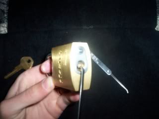

It isn't difficult to pick this lock, but the shackle doesn't open when picked normally.

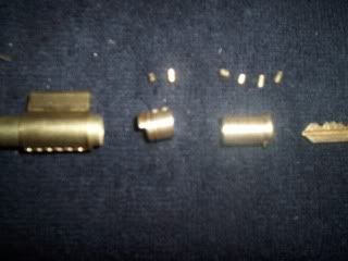

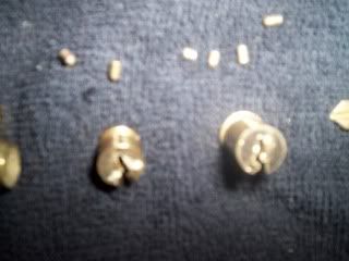

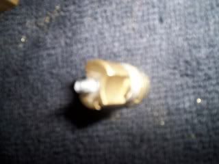

Taking the lock apart. Nothing too weird unless you noticed the spring in the back of the driver.
Normally the lock wouldn't need a spring here. But my modded cylinder needs it to work reliably.
Now you can see how it all works. The cylinder is still a six pin cylinder, but it has been cut in half.
I had to use two cylinders to make one. But only because I can't make a cut between two chambers and still have them both working.

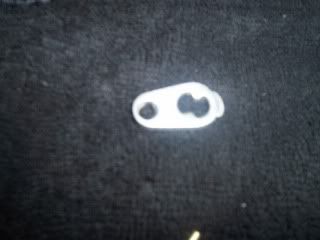

It is important that the lock has a cap like this one to hold the front end of the cylinder in the lock. If you did this with most locks the front half of the cylinder would come out and give you a small headache every time you used the key.
Also note. The ways I can see to open this lock are as fallows: Use correct key, Impression a key, Key bump the lock, use a really long tension wrench, or risk breaking a pick using it to tension the rear plug and pick the last two pins.
Yeah it doesn't sound very secure when I list all those options for how to open it. But it's fun to play games with other lock pickers. Hand them the key and they can open it, picking it they can't. It's fun to watch. :D

I would pick the first half, and pull the front of the cut plug out, and then pick the back part.

Postby Squelchtone » 13 May 2009 13:51
sfi72 wrote:I would pick the first half, and pull the front of the cut plug out, and then pick the back part.
fail. =)
You can't pull it out like a normal rim or mortise because the cylinder is bottom loaded hence the metal plate which has a retaining screw that can only be released from inside the shackle hole.
I think this is a pretty neat idea actually... you could also have lateral holes in the cylinders so that when the front one is picked and rotated it shoots a spring loaded pin (imagine the pin on the back of a schlage clinder which holds the cap on the back from rotating off) into a hole on the 'face' of the cylinder behind it, thus locking up the lock in that awkward position.
man I love trap pins,
Posts: 11341
Re: modified padlock for a little extra pick resistance.
Postby FarmerFreak » 13 May 2009 14:19
The idea of locking the cylinders together after first half turns would be a scary idea. I really would like to be able to open the lock after having someone try to open it. And secondly, it may make it possible to pick the back end of the cylinder if they were to lock up again...pending on the depths of cuts.

Postby sfi72 » 13 May 2009 14:40
fail. =)
Right, wasn't thinking about that plate...

Postby SnowyBoy » 13 May 2009 14:40
Is it just me thinking this, or could you not just pick the back two pins and rotate to unlock?

Postby nothumbs » 13 May 2009 17:01
Might be difficult to rotate just the back half while the front half is still held in position by its pins. Also not clear how you tension the back half without first picking the front half, rotating it just enough to pass its shear line, then sticking a very long tension wrench down to the second half to then pick it and rotate it, which by the way is, I think, the way to pick such a setup.

Postby sfi72 » 13 May 2009 17:12
nothumbs wrote:Might be difficult to rotate just the back half while the front half is still held in position by its pins. Also not clear how you tension the back half without first picking the front half, rotating it just enough to pass its shear line, then sticking a very long tension wrench down to the second half to then pick it and rotate it, which by the way is, I think, the way to pick such a setup.
Whew, lots of commas there.
Tensioning only the back half wouldn't be to hard, all you need is a piece of wire bent in a small L shape. Granted, the wire needs to be fairly stiff but there are materials that can be that small, and strong enough to rotate the cylinder.

Postby ToolyMcgee » 13 May 2009 17:17
Simple enough, but it would sure aggrivate the crap outta me. :mrgreen: This could make a keyway that requires top tension to have to have a special bottom tensioner to even give a hope of picking it. This lock would only be a confusing annoyance, but the potential for something seriously frustrating is there. Impressioning, like you said, is another story. Very cool.
