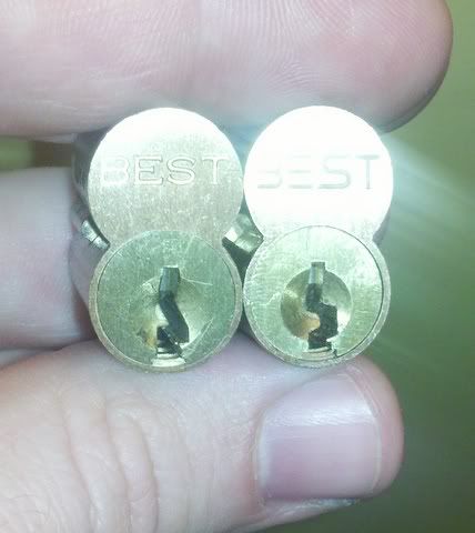

Hi all - I just got a bunch of Best cores, two of which have keys.
Most of them are (I think!) G keyways, and two are either BA or F, best I can tell.
My limited understanding of these locks is that they've got two shear lines, one for the control key and one for normal operation. I'd love to disassemble a few of these to a. see how they work and b. learn them one pin at a time via DB's outstanding method.
First, not having any sort of specialized tools, am I able to disassemble one of these cores? I suppose since I have a bunch I could sacrifice one or two if it would destroy the lock in the process, but I'm really hoping I can do the DB exercise. Also, can I disassemble the ones without keys as long as I can pick them?

theTastyCat wrote:First, not having any sort of specialized tools, am I able to disassemble one of these cores? I suppose since I have a bunch I could sacrifice one or two if it would destroy the lock in the process, but I'm really hoping I can do the DB exercise. Also, can I disassemble the ones without keys as long as I can pick them?
@theTastyCat:
While you can take those cores apart as if they were normal cylinders, you can not do so while they are still keyed... The tolerances are much too tight to shim...
To re-key a Best style SFIC core with individually capped barrels you would use a smooth ejector pin in the tiny holes on the bottom of the core and carefully force out the pin stacks...
I am sure you could find a nail that would fit into the ejector pin hole, just make sure that whatever you use is smooth and won't create a burr in the barrel or it could cause the core to bind...
You have a large variety of cores there in the picture, some 6-pin some 7-pin... You could be right on with your guesses at the keyways, another possibility would be H...
