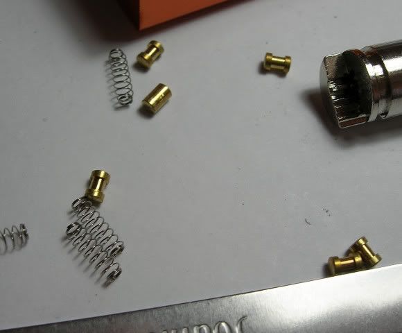

Postby stilte » 30 Nov 2006 4:08
Here they are. Took faster than I expected.
Clicky:
Keyway
5 spools and 1 normal
stilte

Postby ooops » 1 Dec 2006 17:45
I'm in the U.S.
5 spools and 1 normal? I could have sworn mine had only five pins total... I'll go recheck.

Postby stilte » 1 Dec 2006 23:02
You may be right, yours might have 5 pins.
http://www.mrlock.com/eshop/locks/mfg/abus/8345.html wrote: Pin Tumbler Security, 5 or 6 pin.
Look at the key and you'll see how many pins it's got.
