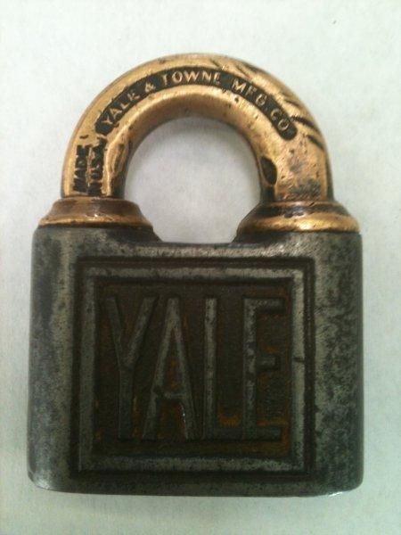

Recieved a challenge from a locksmith friend. I was challenged to make a key for this Yale Push Key padlock:

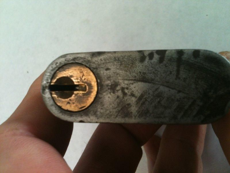

Notice the warding... or lack thereof...
You can see how the pins were origionally inserted below:

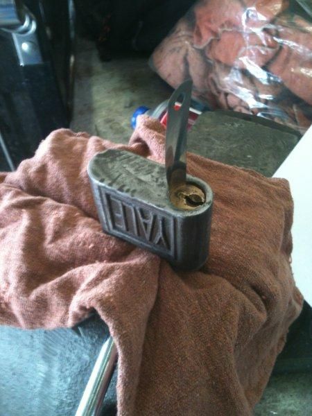

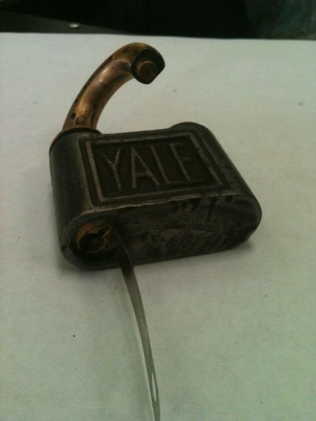

I had never seen a push key lock before, so it fascinated me to try. First, I used a shim and a hook to find the shear line. Note: I was warned that the plug would NOT turn until the key was correct and the shackle was lifted up high enough to clear the lock body.

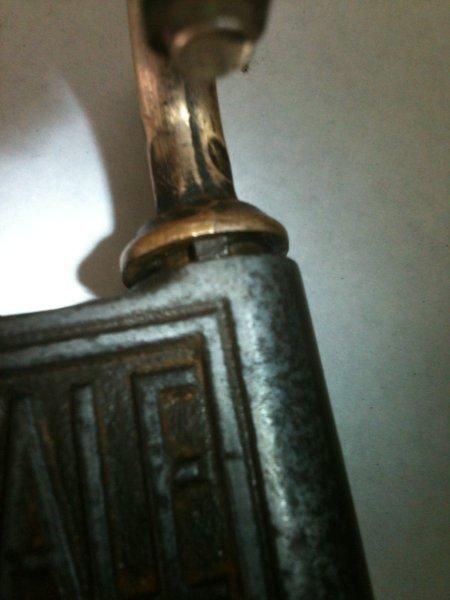

Once shimmed, I used a screwdriver (with a rag to protect the lock) to lift the body from the shackle. This is when I found out that the shackle and plug were ONE PIECE. That is why it would not turn until lifted.

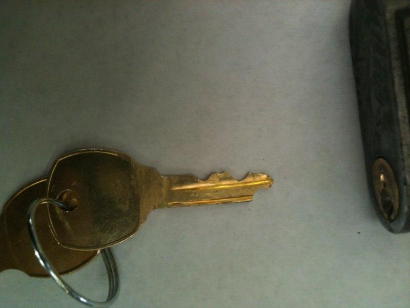

Once the plug was lifted and turned, the pins could not be lifted higher, of course. This gave me the oportunity to figure out the key bitting. Used a flat key, already marked to show where the pins would be (got the spacing from the side of the lock, seen in the third picture.) Looking into the keyway with the plug turned, I could see that the first bitting was the second deepest cut of the four, and the third bitting had the deepest. By feelng with a hook, I could feel that the second bitting was at, or nearly at, the highest point possible in the keyway, and that the fourth bitting was at about the middle.

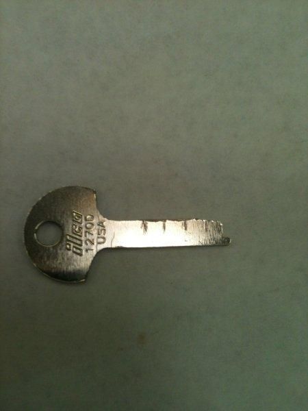

Once the light levering opened the lock with the key, it made great impressioning marks, allowing me to fine tune the key.
And now the finale... The lock opened with the key.

I received my Yale today it is nice condition. I was hoping it wouldn't have some unexpected problem like stuck pins, clasped springs and it was just fine. I shimmed it open used a hook pick to feel the length of the pins and lucky the last fat pin was very shallow cut so blank went in no problem. This was an easy one cuts look to be 2242. Filed down the sides of the National 4 pin blank moved the shoulder and bottom of key head to allow the blank to be long enough, scribed the side to mark pin location, hand filed the cuts to what I eye balled the pin levels to be when opened. Worked the first time I inserted it. Pins left some nice mark because 2 of them wasn't yet deep as should be finished it off with very little correction nice a smooth. I will order the proper blanks tomorrow. So all I have to do is copy this key to the right blanks and maybe clean the lock a little. These are fun locks to do. Been a long while since I did one but seeing you and Lauren doing these made me want to get one without a key to make sure I haven't lost my touch. :D

Whoops forgot to add the picture with key in it that shows it really works. I could have laid any key next to the lock and said looky here I made this key to this Yale. So here it is open. Hope others will be inspired to get one and try it. The first one you do can be very challenging but you get a great feeling of accomplishment when you get it to work for sure. :wink:
