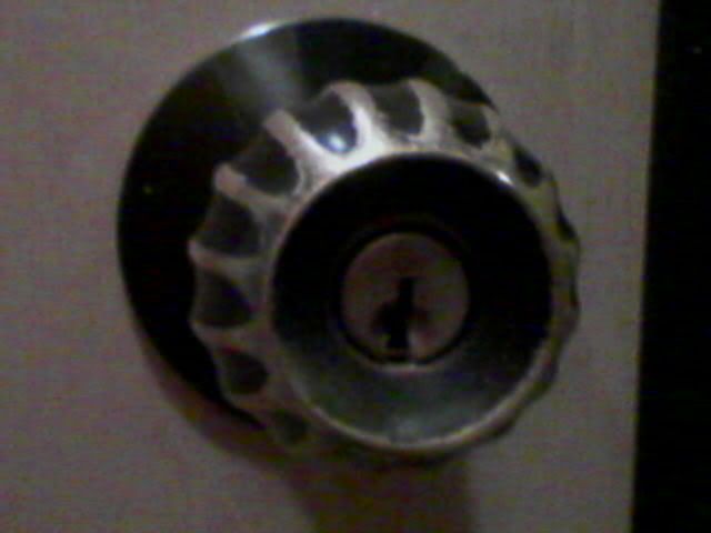

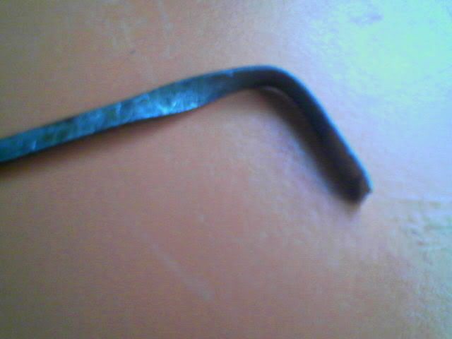

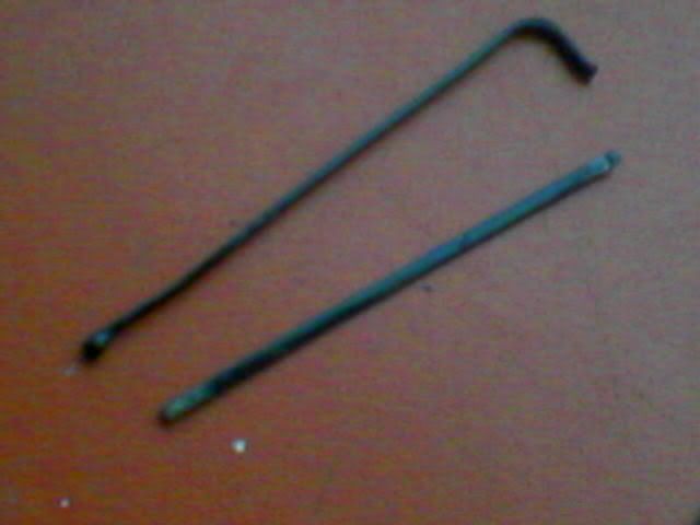

I decided to go to the store, and absentmindedly left my apartment without grabbing my keys. I shut the door and immediately realized I had just locked myself out of my apartment. *sigh* I went to the managers apartment however he was not home. He has a day job and would probably be out for a few hours. I didn't want to walk out the front door of the complex to finish my buisness, so I was effectively stuck. I wandered back to my apartment but on the way back something caught my eye, one of thoes large 2mm thick bobby pins. It looked sturdy enough I thought, I'll give it a try. I bent the pin straight and bent it into an 'L' shape, then a quarter inch from the bend began to bend it back and forth to break off a 'pick' I worked at it and after a few minutes I had a satisfactory tension wrench and a makeshift pick
I went to work on the lock
I couldn't feel the pins very well but after a few minutes I felt the pins set (!)

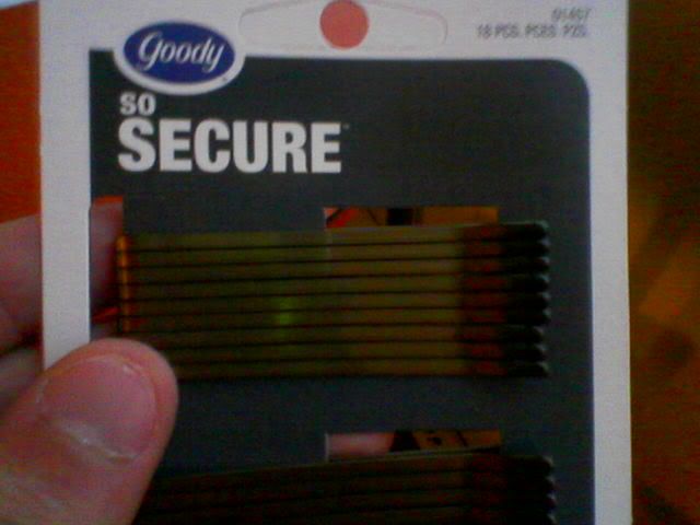

I opened the door, grabbed my keys, and went straight to the store to pick up some more of thoes pins.
Ironically named "SO SECURE" :roll:

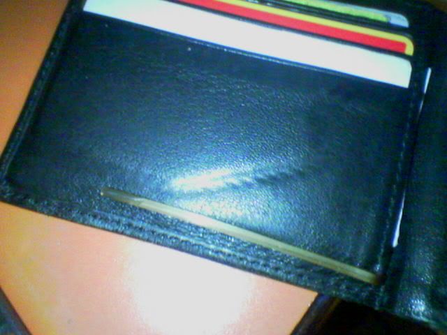

they now fit nicely in my wallet.

Yeah, larger than normal Bobby Pins. You should have no problem finding them at a drug store or Hair supply place.

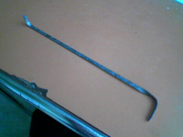

I've been picking locks as a hobby for about 2 years. Never had to open a lock for real though. I was discouraged for awhile because I was having a really hard time with the nessassary pressure on the tension wrench. I was walking home one day and noticed a street sweeper. I followed him for a few blocks and got 5-6 good bristles and made myself a great tension wrench which dramatically improved my sucesses. I would suggest this to *anyone* having problems. I know it turned me back onto picking. The 90 degree bend really helps to apply the perfect tension.
I made this one without any heat as I was having a difficult time applying the perfect heat and re-applying heat to harden it. Its a great wrench but some locks (especially older ones) can have grimy plugs that require alot of torque to turn and the wrench will start to bend a little turning it. I keep a thicker wrench from "Magestic" around to help with difficult plugs.
