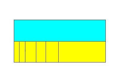

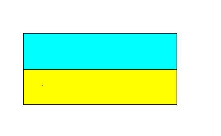

1. Cut around the rough plan of the base of the case ( the main part.)
2 . Cut your pick pocket(s) out and sew it/them to the base.
**The base is light blue, while the pocket is yellow**
3. Sew the pocket dividers to the length you wish to have it.

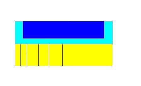

4. You will need a flap that folds down so that when the case is folded the picks will not fall out of the top.
**sew along the top 1 cm of the flap "which is in blue"**

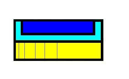

5. Now we are ready to sew the edging to neaten the case up.
( for leather this is not needed )
Grab your "seat belt material" and fold it in half over the edges and pin it there. sew along the inner edges of it.
if you cut this material use a gas torch or a stove to melt the edges so if something catches it the material won't come apart.
**Almost finished :D **
