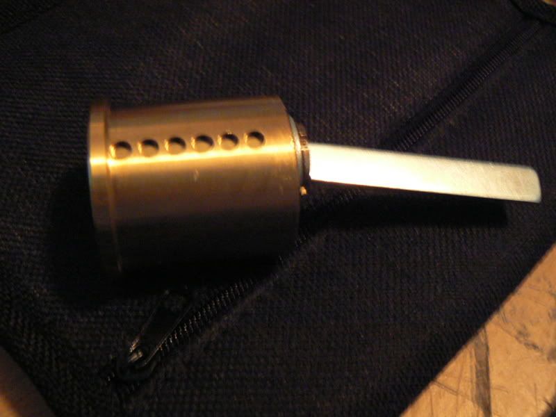

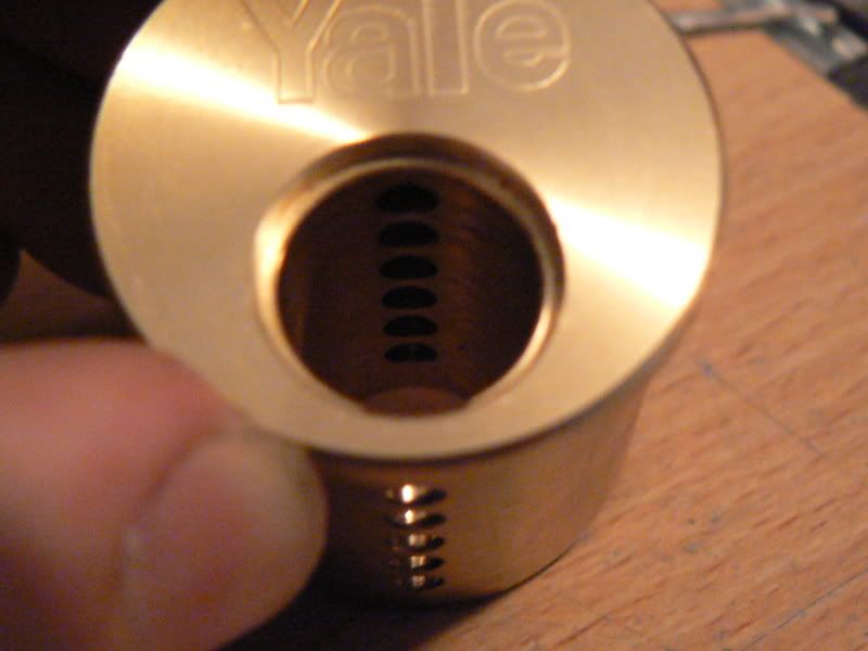

the bottom side of the lock showing that it has six chambers

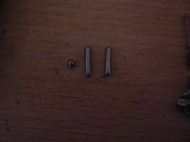

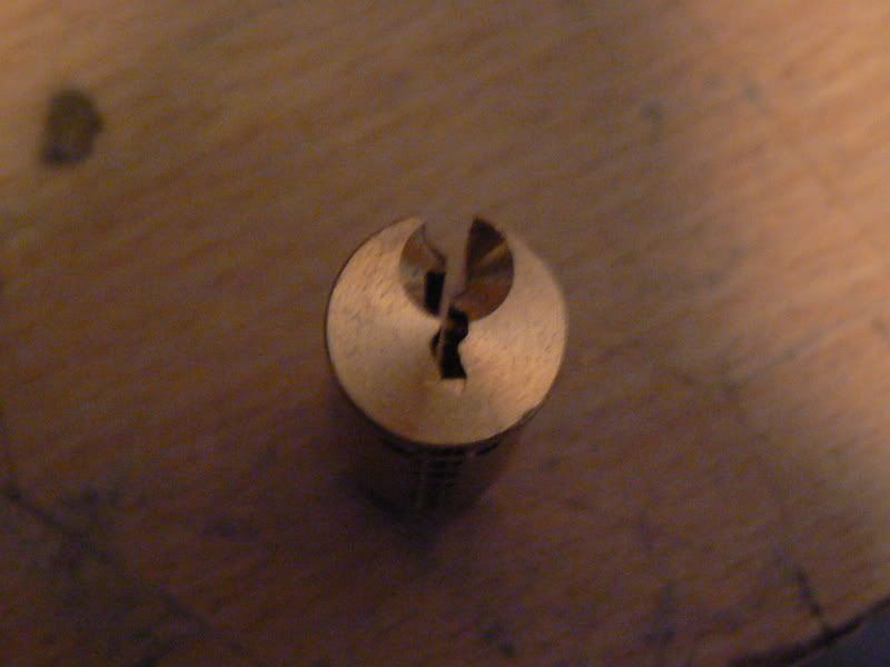

the plug, you can see that it has two roller bearings and one ball bearing to resist drilling.
the keyway.
the hull.

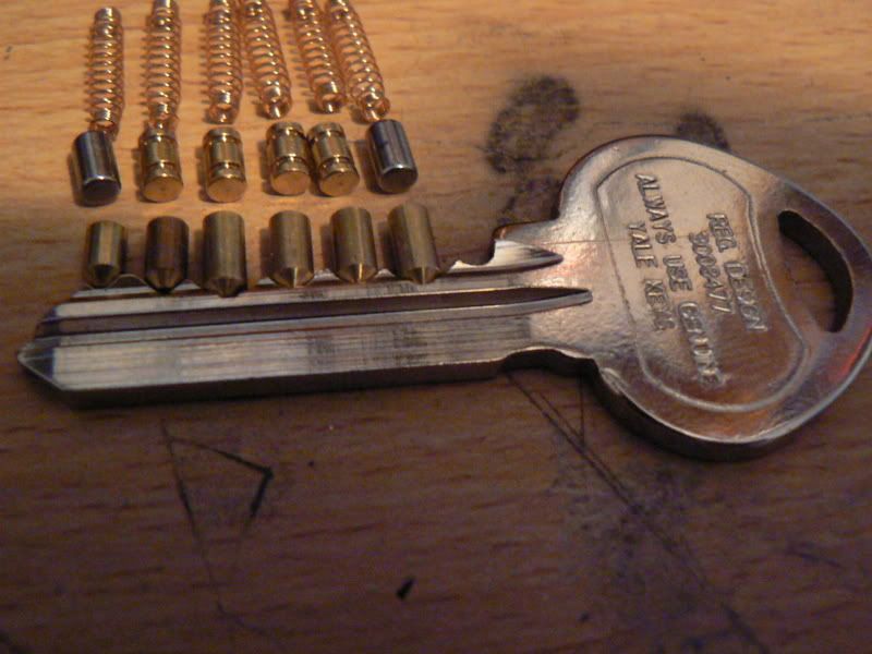

the key pins, driver pins and springs against the key.
again the key pin, driver pin and springs. as you can see four out of the six driver pins are security pins and the other two are just normal one i believe.

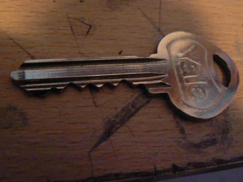

the key.

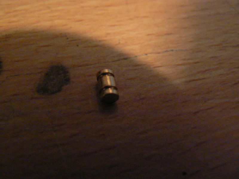

close up of one of the security pins
and the anti drill bearings.

The thing this has in its favour is that they are all spools, this means each stack will react the same when being picked,
Use feather tension and feel for the steps in the pins,
A lot find it easier to slightly over lift the pins in these and then allow them to drop to shear,
Postby digital_blue » 9 Apr 2007 8:59
I would think those would act more like serrated pins than spool pins, since there's no real gap to get hung up in.
