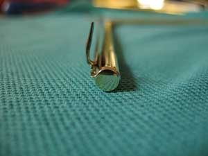

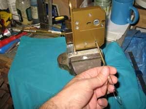

Yesterday I picked an ERA Invincible sash lock, my first BS 5 lever lock !

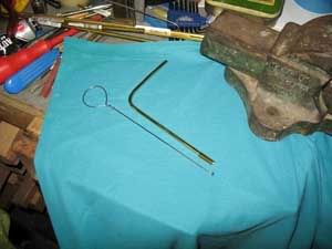

Not being a locksmith or having access to any commercial curtain picks, it was out with the pen and paper and time to put the brain into overdrive
A basic design in my head and some measurements it was time to make the tool
With brass rod, piano wire, silver solder and a selection of hand tools my pick was born
I opened the lock six times after lunch
To say I am pleased is an understatement :D

I've had the lock about two weeks, took it apart on day one and made some measurements and rough sketches.
Bought some materials the following weekend, and got round to making the tool this weekend. It turned out pretty close to what I envisiged.
Picking time varies as you would expect with a new technique to learn, between one and a half minutes to maybe five minutes or more.
I picked it again when taking the photos, I could not resist it ! :)

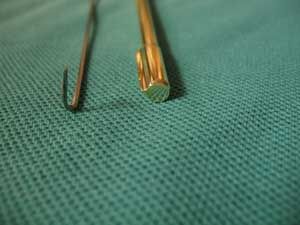

Can I ask how you shaped the end of the brass bar or did it already have that shape on it? Looks good,
I've got a pick that I made (a few years back) out of a spiral sash spring tensioner, I say made, it's almost exactly the right shape to start with but a bit shorter in length than the one you have there.

jb68 wrote:Can I ask how you shaped the end of the brass bar.....
I silver soldered a collar and a small length of brass to the end of the brass rod and used a hand file and needle files to get the shape.

Postby snapcarp » 7 Sep 2006 13:50
NickBristol
The piano wire is 16 swg (approx 1/16th inch or 1.63mm diameter), available in 3 feet lengths, I paid about 50 pence per length.
Bought from a Model Shop in Banbury. They also stock K's Metal, brass and alluminium tube and rod.
