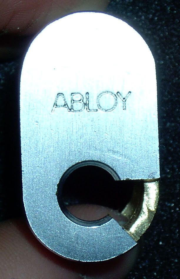

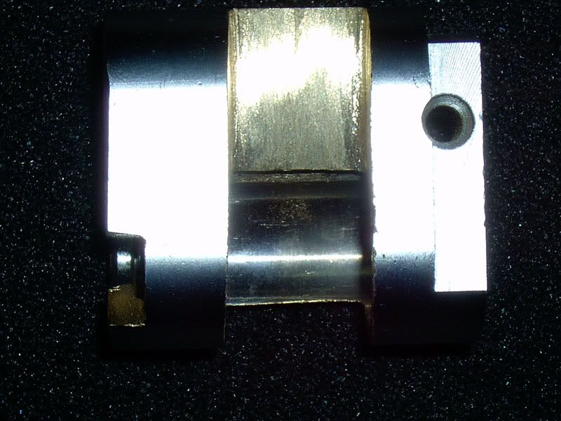

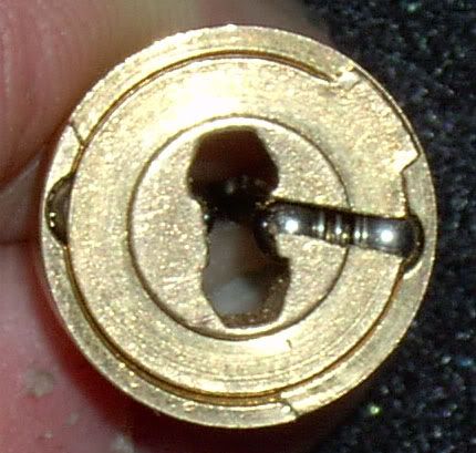

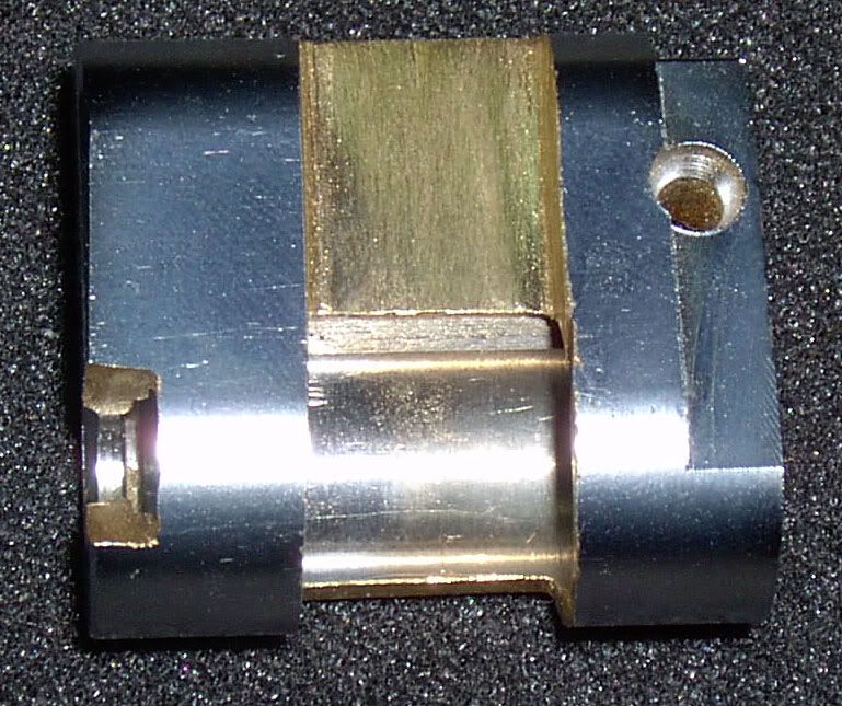

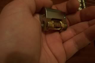

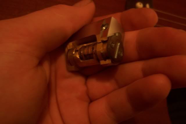

I haven't made a cutaway in a couple of weeks, so I picked up my Protec oval cylinder and started sawing. It's not finished yet, but I still felt inclined to share it. It will, most likely, be auctioned off when I can either obtain a key or key the lock to one of my other protec keys.

Nice work so far! but have you cut the cylinder yet?
Also, i got a key for the protec from work but im not sure that it is the correct profile.

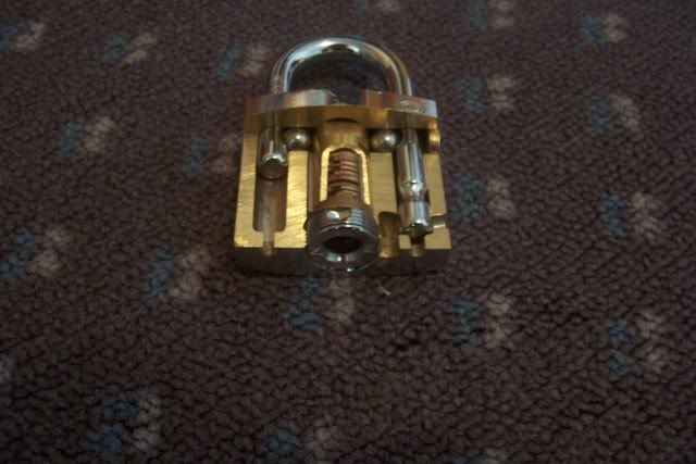

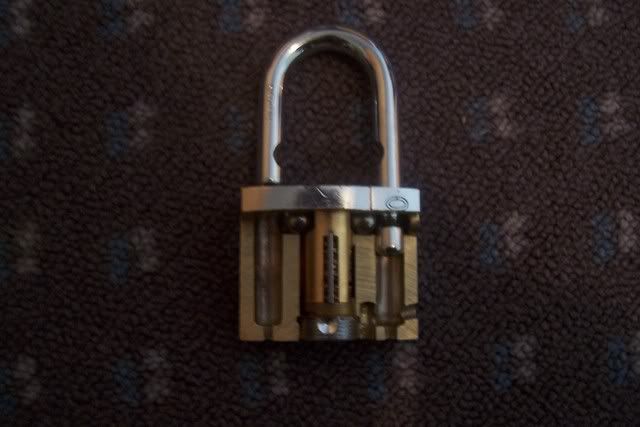

Just 2 of my 42 cutaways:
Protec - Unfinished
Disklock Pro

I haven't been working on the Protec lately since there is nothing to do on it. Skold, the profile of my lock is the H profile. I don't have any other locks with the same profile so I'm screwed if I can't get a key cut. I've been trying to decode the disks, but with no success.
I also like how you cut away that DiskLock Pro.

I see those giant ball bearings from time to time inside locks. I know they are some type of security measure. But could someone tell me specifically what they do?

Postby dougfarre » 15 Feb 2008 12:43
n2oah, I know all to well how difficult it is making a cutaway on a disk lock. Your precision is outstanding, and cuts are perfectly strait. I don't know how you do it.
Gelmar, the giant ball bearings are are security measure alright. They are for keeping the shackle secured when it is locked.

Postby Gelmar » 15 Feb 2008 14:33
Yes, I realize that but what makes them better than a normal clasp. Are they more shim proof? Or do they help prevent something else. I mean why balls? I don't understand! HELP ME!!?!

Postby Gelmar » 15 Feb 2008 14:36
Sorry for the double post here but I left something out.
I only ever see them in "Higher security" padlocks. What makes them better? Thats what I'm trying to get at.

Postby TOWCH » 15 Feb 2008 15:49
Spring loaded hasps can be shimmed, bounced, pulled, ect. They just generally suck.
Ball bearings suffer from none of these flaws. To bypass them you'll typically end up slotting the face of the lock, and turning the spring loaded obstruction manually; or drilling out the obstruction all together.
I need to go back to school. I can't remember proper terminology any more. :(
They also offer tremendously good pulling strength, which is the primary reason they are used on good locks.

Postby TOWCH » 15 Feb 2008 15:52
The ones in the keyway are like a ward to make decoders more difficult to design, without the downside of weakening the key at low cut locations.

Postby Jaakko » 17 Feb 2008 5:20
TOWCH wrote:The ones in the keyway are like a ward to make decoders more difficult to design, without the downside of weakening the key at low cut locations.
The reason they are added to locks is patent extension whoring.
The reason why those are added is because you can brake the lock with the key if it is not inserted all the way in before turning. Abloy Disklock was discontinued because of this and Disklock Pro introduced.
What comes to making decoders harder to design, well, those doesn't work like that ;) Can't say anything more as this is not advanced area.
For n2oah, those are some pretty impressive cutouts. You probably use proper milling machine, atleast for the padlock that is in half? :)

Postby n2oah » 17 Feb 2008 14:19
Jaakko wrote:For n2oah, those are some pretty impressive cutouts. You probably use proper milling machine, atleast for the padlock that is in half? :)
Nope, the only thing I use for my cutaways is a dremel and some modified files. :)

Postby Jaakko » 19 Feb 2008 5:10
Ah, silly me, I looked at skolds photos :D Oh well, atleast now I know :)
