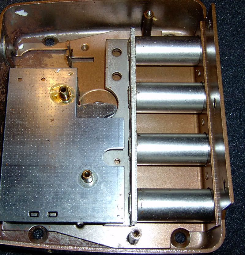

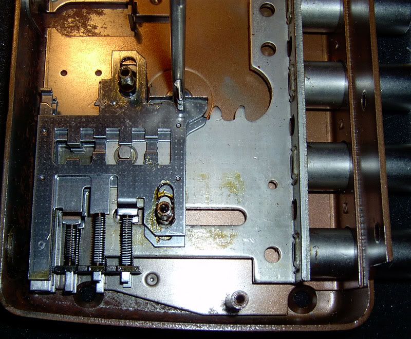

Here is my newest lock from eBay, a Cisa 57110. It would be nice if you could tell me what kind of mechanism this lock uses. I believe it is a complex warded lock. Anyways, poorly lit pictures are below.

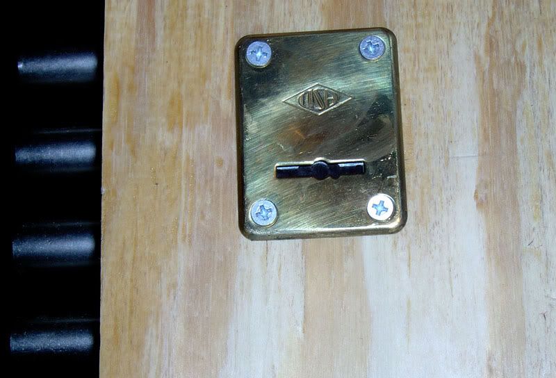

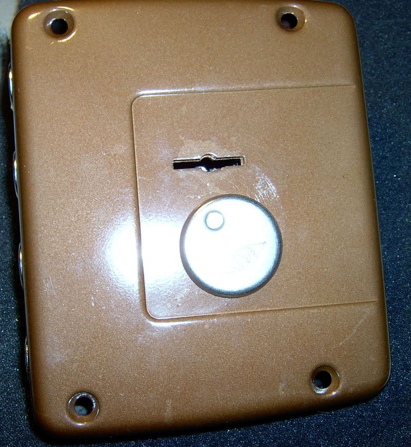

The exterior side:

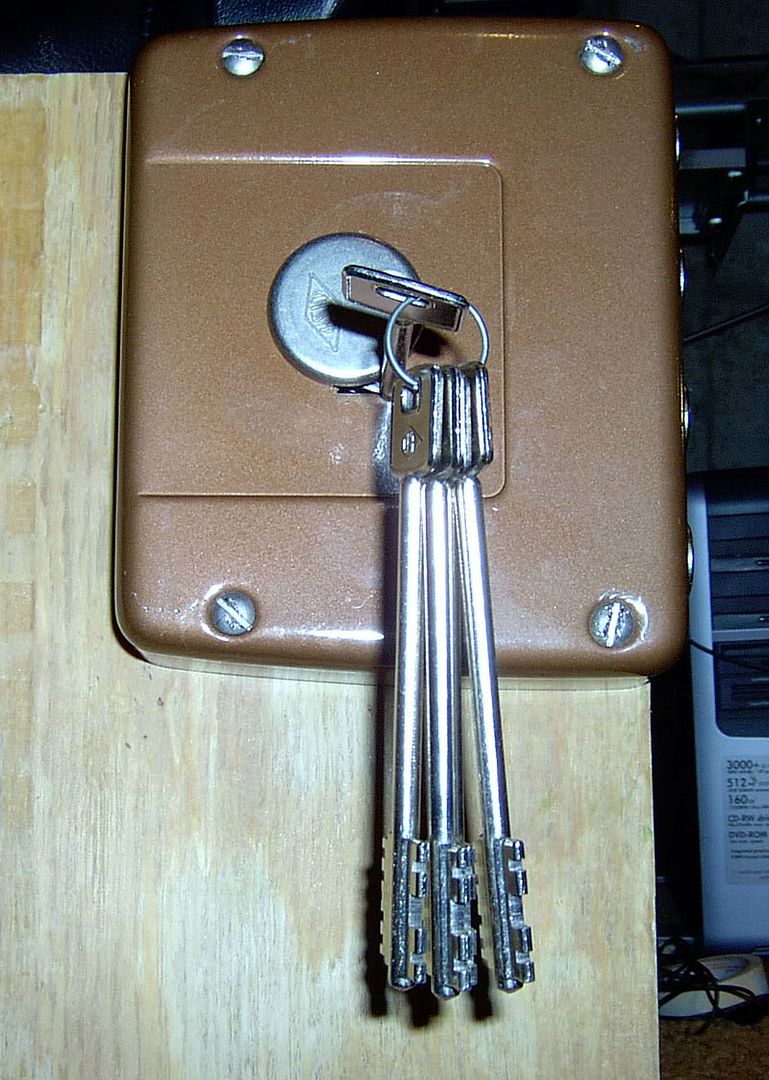

The interior:

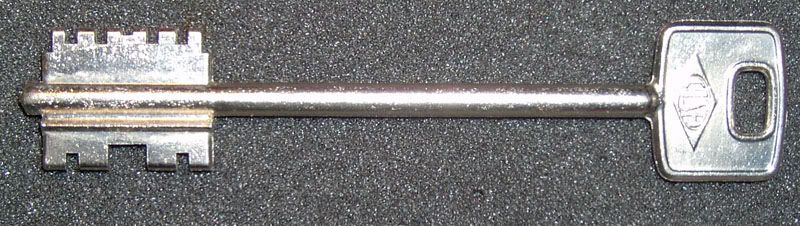

The key:

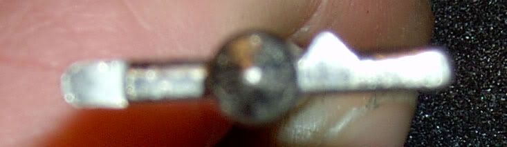

The key profile:

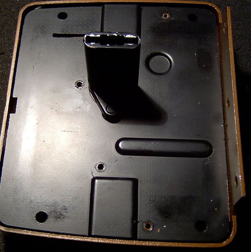

The exterior face taken off:

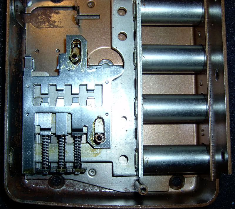

The plate over the levers taken off:
The key turned halfway:

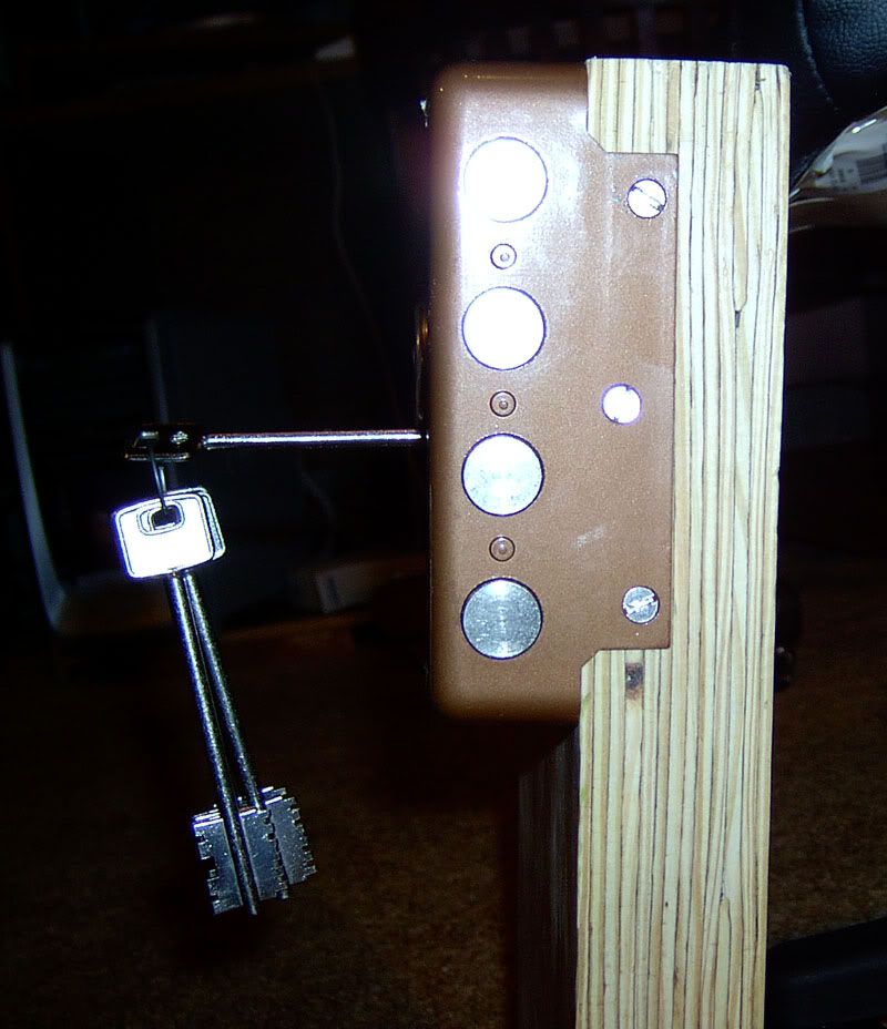

I'll probably get around to mounting this lock once I find a decent piece of wood for it.

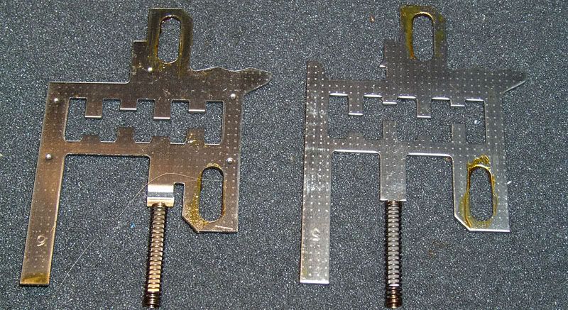

A 6 and 5 lever:

Postby What » 27 Mar 2006 22:01
it looks like a lever lock to a certain extent, but im not sure...

Postby skold » 28 Mar 2006 7:03
It's a safe lock.
And also one of the lever kind.

Postby illusion » 28 Mar 2006 12:08
You would have to pick the lock 4 times to fully withdraw the bolt. Once it moves forwards a bit it'll stop and settle up against the next fence. Seems like a good challenge. :)

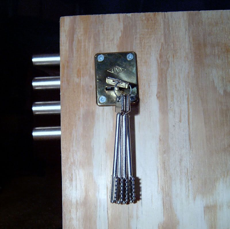

Postby n2oah » 30 Mar 2006 2:29
I went dumpster diving last night and found a nice, thick piece of wood to mount all of my HS locks on. I don't have the board painted yet, and it doesn't have a base either. Tonight, I mounted the Cisa. I plan upon mounting my Miwa EC deadbolt tomorrow, that is, if I can find that darn hole cutting drill bit.
Notice that I stripped most of the bolts on the back, that is because the hardware wasn't very good.

Postby mh » 30 Mar 2006 6:29
skold wrote:It's a safe lock.
It's a lever lock, however, for some strange reason this particular type of lock is designed for house doors, not for safes.
cf. http://www.cisa.com/flex/cm/pages/Serve ... agina/1920
Apparently, some Italian customers are afraid that someone might use a saw on their deadbolts, so they have 4 bolts...
I've seen similar locks actually mounted in Italy; IMHO it was some kind of overkill for the not-so-strong wooden doors they were mounted on :)

Postby n2oah » 31 Mar 2006 15:59
So there are no criticisms about my installation? :)
n2oah
Posts: 3180
Joined: 13 May 2005 22:03
Location: Menomonie, WI, USA
Postby mh » 31 Mar 2006 16:42
n2oah wrote:So there are no criticisms about my installation? :)
No, think you did that as well as any Italian carpenter could do that :D

Postby NKT » 20 Jan 2009 15:14
It's certainly a lever lock. The double bitted key is similar to those found on safes, but the lock itself is not. Against brute force, this is probably a very good lock, but against anyone who can pick a BS lever lock this isn't going to be a big challenge, once a centre tensioner is made.
The double bitted key is symmetrical, which reduces the security, as it only needs decoding once, and there are no anti-picks. Properly equipped, I'd rate these as ten minutes at most, NDE.
