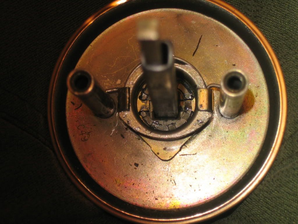

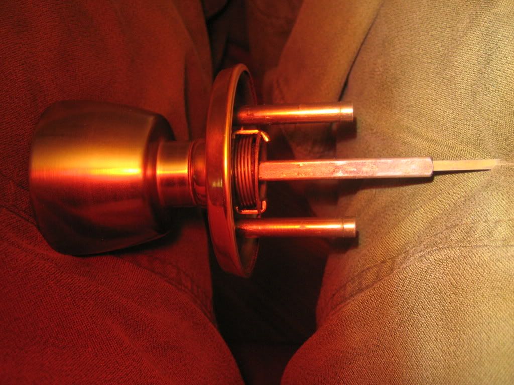

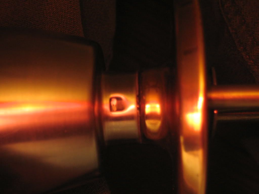

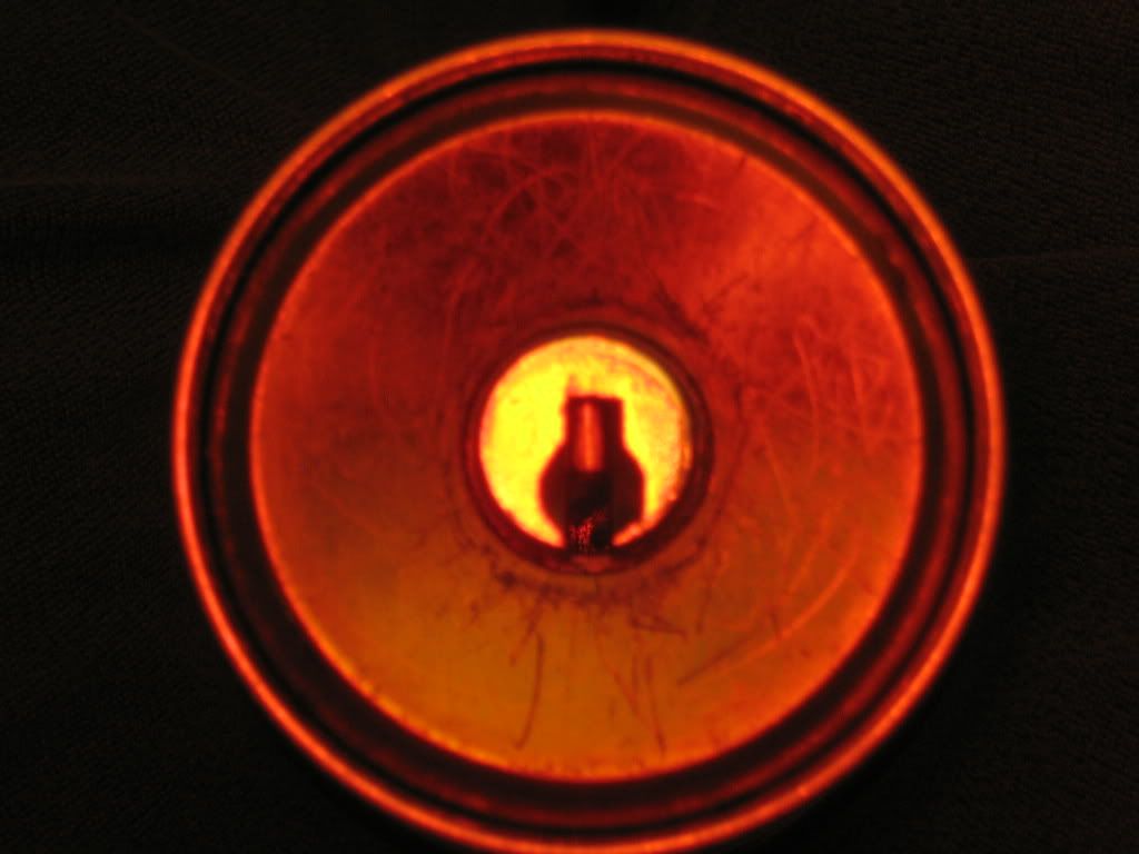

This door knob is making me feel dumd can't figure out how to take it apart to rekey the cylinder( yeah I know it's cheap but I want to do it for personal reasons) I have an idea of how but it's not solid and I think I may maqke the knob itself N/S so.... Help me ....man this make me feel sooo nOOb. cheap wiser knock off has me stumped... I can strip highsecurity locks just fine... well pics below

Gosh, what a HUUUUUUGE keyway. Have you tried crawling in there with a flashlight looking for a retainer bolt? :twisted:

i can't tell from your picture- on the ring between the rosette and the actual knob, there is an indentation. it is fuzzy- so i can't tell if it is just an indentation, or if it is a slot. if it is a slot, with the handle unlocked, rotate it. you should see a flat piece of metal, about a centimeter long and a milimeter or so wide-
depress this with a tool while pulling on the handle.
with some locks, the key must be turned in the cylinder (or the plug picked, either way) and turned to a specific position for this to work- you can apply pressure to the tab while turning the key, and when you feel it depress (the tab of metal) then pull

BTW I am familar with doorknob disassmbly, just not this one. I'm thinking that the indents just above the roset need to be 'popped' out for the handle to come out.... thoughts

Pull the metal rod ( see arrows in the picture) away from the face of the
lock . while holding the rod "out" . pick or use a key... turn 90 degrees .. pull ... the cylinder will come out the face similiar to a kwickset
