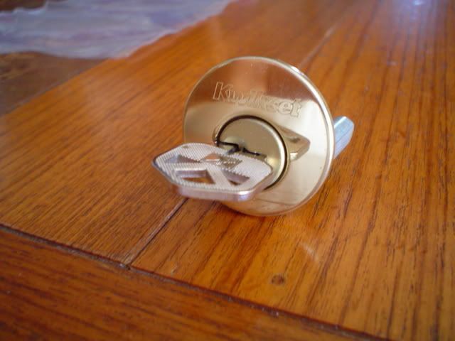

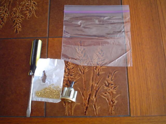

First, here's what you'll need:
1. A plastic ziplock bag, a flathead screw driver, and of course spool pins.

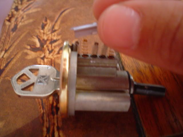

2. Put the key in and turn it to the side, this is to prevent the bottom pins from falling out along with the top pins when you take them out. It should remain in this position until you are completely done.

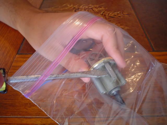

3. Put the cylinder in a ziplock bag and remove the spring cover using the flathead. The use of the ziplock bag is to prevent you from losing springs or pins in case something flies out (it is not an original idea of mine).

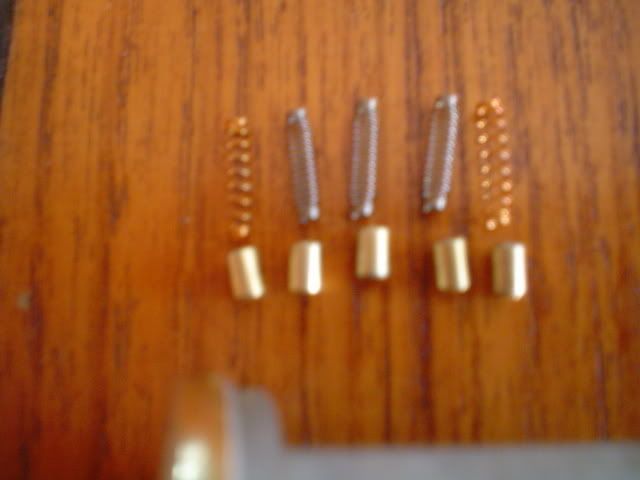

4. If you are careful or sufficiently experienced this should be the result after removing the spring cover.

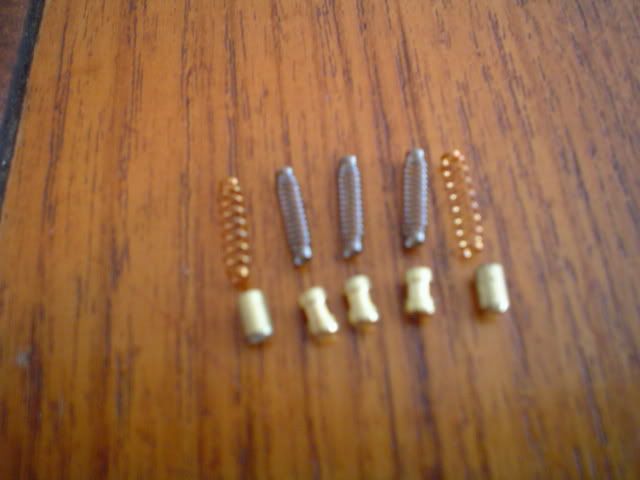

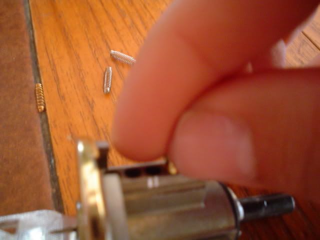

5. Turn the cylinder over to spill out the springs and top pins.
6. Replace the regular top pins with spools. In this case I am putting them in positions 2,3, and 4.

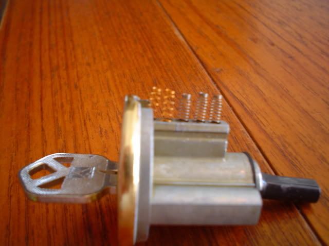

7. Put them back in along with the springs.
8. After the top pins and springs are in place, put the spring cover back on. It is a thin and malleable piece of metal and should snap back on with a little force.
9. The cylinder is now ready for practice or to be re-installed.

Springs
Postby danceswithpins » 1 Apr 2007 13:51
Why are the spriings different when he opened up the original configuration??
dnaceswithpins
danceswithpins
Posts: 17
Joined: 11 Mar 2007 19:25
Postby UWSDWF » 1 Apr 2007 13:53
I would think he's repinned this lock before and had to replace a couple of springs
Postby danceswithpins » 1 Apr 2007 14:03
Will having different springs effect the squishiness of the particular pin verses another pin, making it harder to sense what is happening in the lock??
danceswithpins
Posts: 17
Postby Jaakko » 1 Apr 2007 14:23
It has an effect to the feel but it doesn't get you "blind" to the lock. Sometimes while practicing, the different springs acts little like repinning to a different depths and I've found it very useful :)
