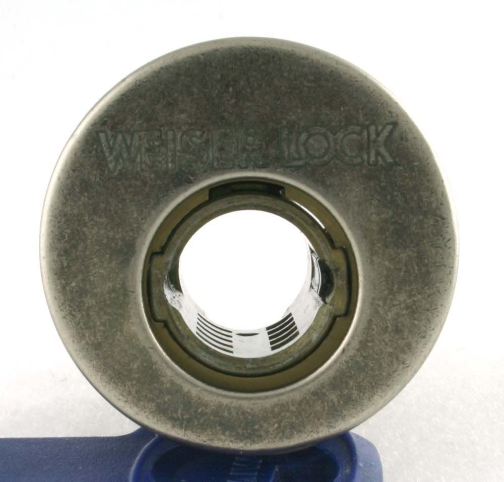

I recently traded for a weiser smartkey from a fellow 101'er. It arrived today and so far I am pretty impressed with it. I have picked it now which took about 20 minutes the first time. The feel of the lock is very odd indeed, sort of "mushy". I have picked the lock several times now and will soon rekey it and try again later tomorrow after work. Here is a list of likes and dislikes of the lock:
Like:
-Instantly rekeyable by end user
-No loss of permutations when rekeying multiple times
-Bump PROOF
-A giant leap forward in pick resistance compared to kwikset/weiser originals
-Easy to disassemble and reassemble
Dislikes:
-Very possible to fubar the rekey process and end up in a lockout situation
-The sidebar springs feel weak. Not at all the the noticeable click of a medeco or primus lock. Could be an issue of durability after moderate use.
-Uses a KW1 blank
I will post some breakdown photos hopefully late tomorrow night but there is my opinion of the lock in a nutshell.

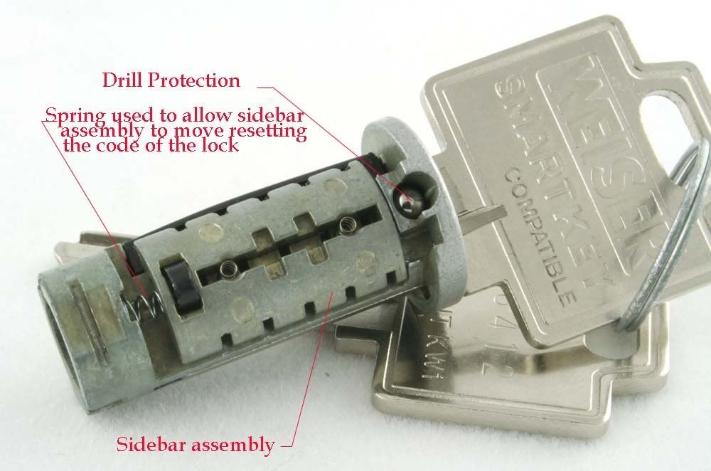

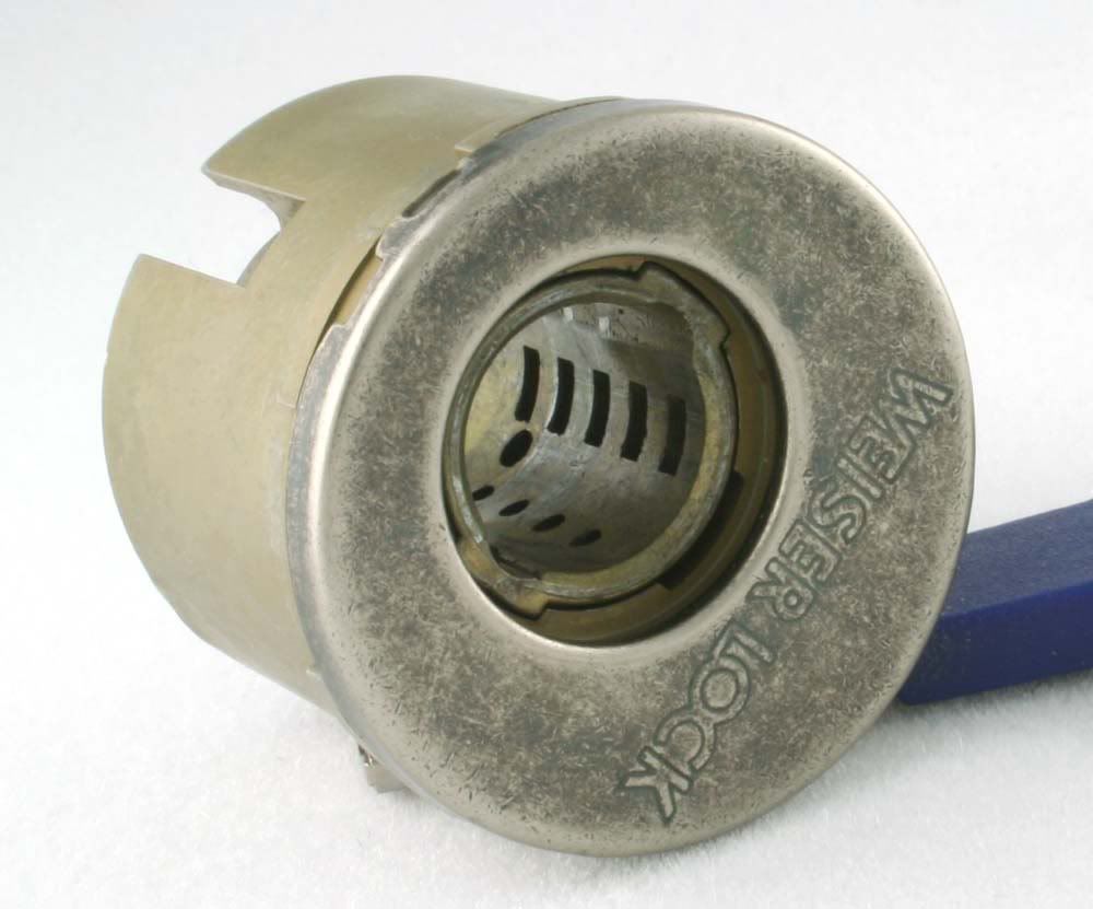

Postby zeke79 » 20 Mar 2007 20:14
This lock is not on the US market yet.

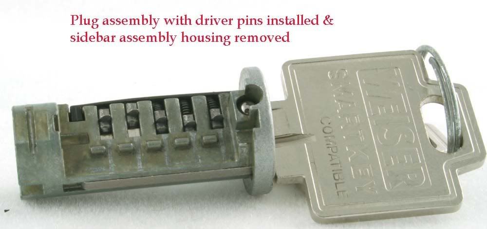

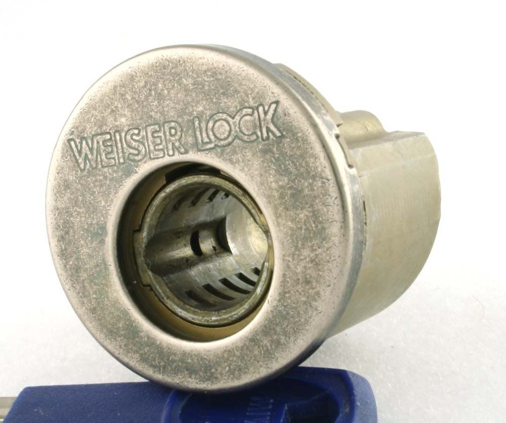

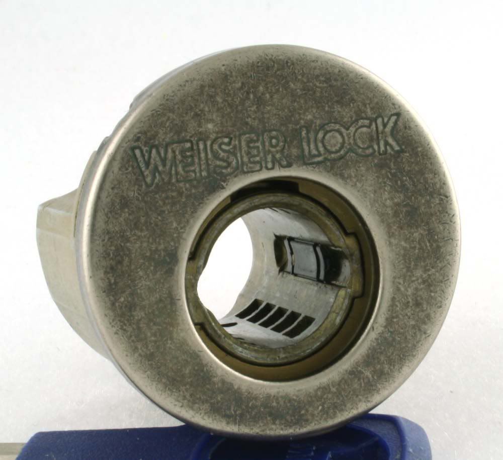

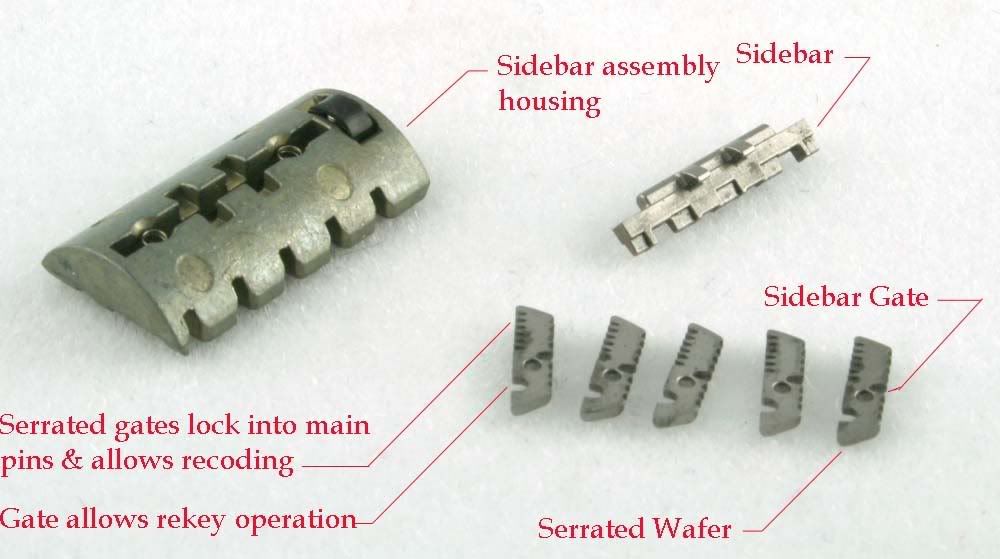

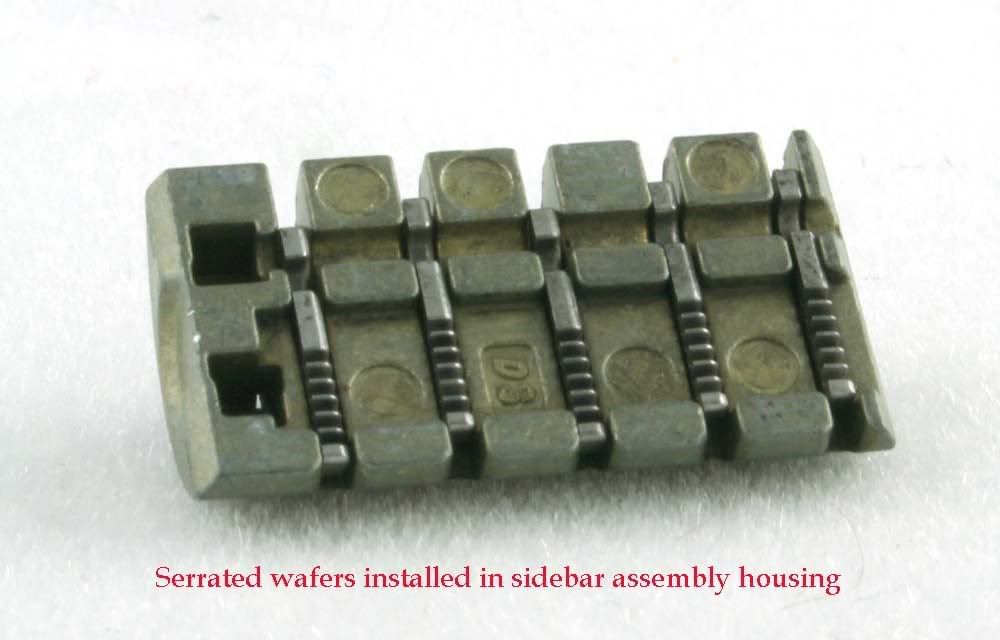

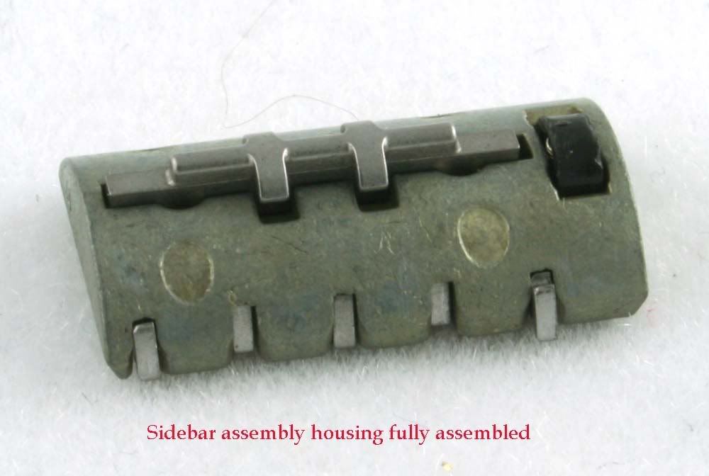

Pics of the lock
http://img.photobucket.com/albums/v375/zeke79/sk1sm.jpg
http://img.photobucket.com/albums/v375/zeke79/sk2sm.jpg
http://img.photobucket.com/albums/v375/zeke79/sk3sm.jpg
http://img.photobucket.com/albums/v375/zeke79/sk4sm.jpg
http://img.photobucket.com/albums/v375/zeke79/sk5sm.jpg
http://img.photobucket.com/albums/v375/ ... sk6smt.jpg
http://img.photobucket.com/albums/v375/ ... sk7smt.jpg
http://img.photobucket.com/albums/v375/ ... sk8smt.jpg
http://img.photobucket.com/albums/v375/ ... sk9smt.jpg
http://img.photobucket.com/albums/v375/ ... k10smt.jpg
**Forgot to add, in the 9th pic there is a clip on the sidebar assembly housing. This clip holds the sidebar housing assembly back inside the shell during the rekey operation. Once a new key is inserted, turning the lock forces the sidebar assembly housing forward as the clip slips out of the detent in the shell**

Postby zeke79 » 21 Mar 2007 13:30
I think you are talking about U change locks. These locks (smartkey) have a different security flaw that is serious and very obvious when you take one apart and start looking at how it is made.

Postby zeke79 » 21 Mar 2007 15:42
No, the mechanisms are different. I am sure there are some Uchange it lock breakdowns around here somewhere. You can compare the pics and see the differences.
U-change link. As you can see, the Uchange operates on a different principal.
viewtopic.php?t=13538
Postby unjust » 21 Mar 2007 16:57
so if i understand the difference is a side by side meshing adjustable pin instead of an internal sleeved adjustable pin correct?
