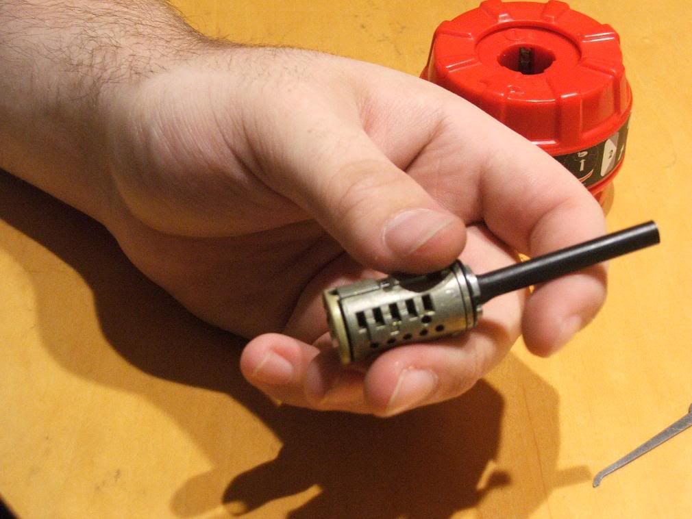

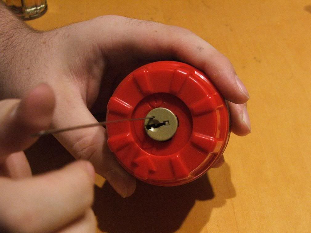

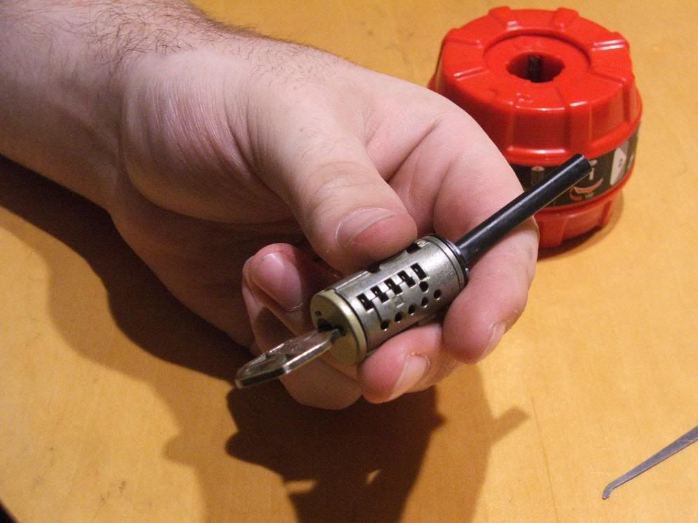

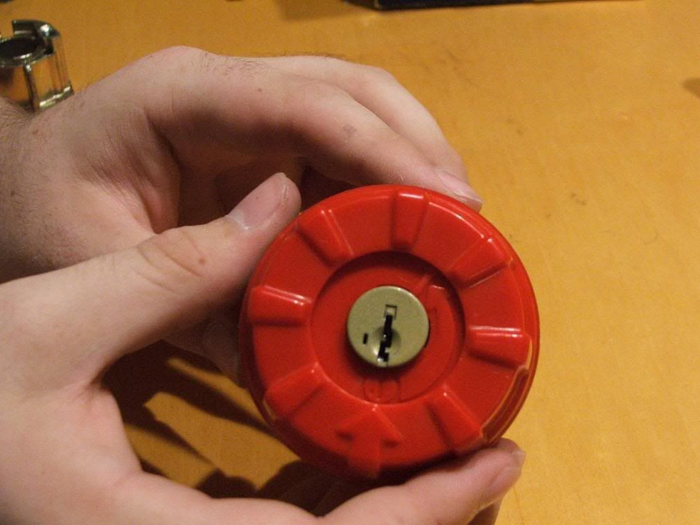

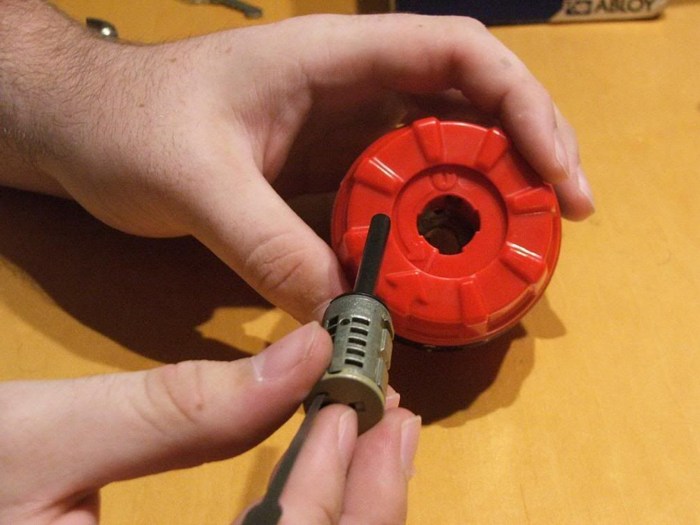

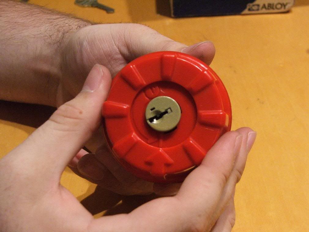

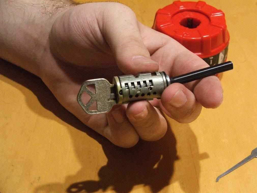

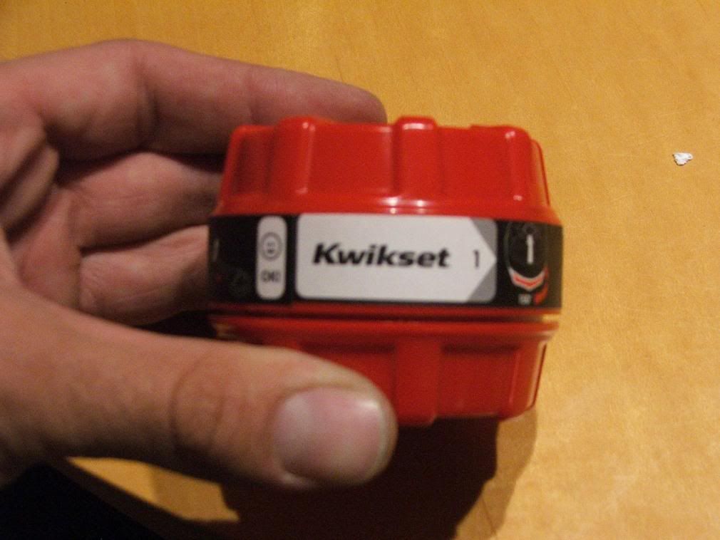

Quite Possibly the Single Greatest Lock Ever Designed? I think so, and the Kwickset Safekey Cradle proves this. So if you loose your key to your safekey lock, but you manage to find a way to get at your safekey core another way, you can still reset your lock, without picking it. Its an amazing little contraption, and I have yet to discover its magic. But i do know it works, and i will show you how.. Although it will be hard to see much....
Step one
TURNING
Stick the Pick in the Smart Key Hole
Take the core out
Put in the new Key
Do a quarter turn counter clockwise
Now it is rekeyed to your new key, reguardless of what the old key was, or whether or not you had the old key.

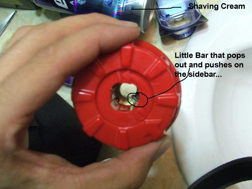

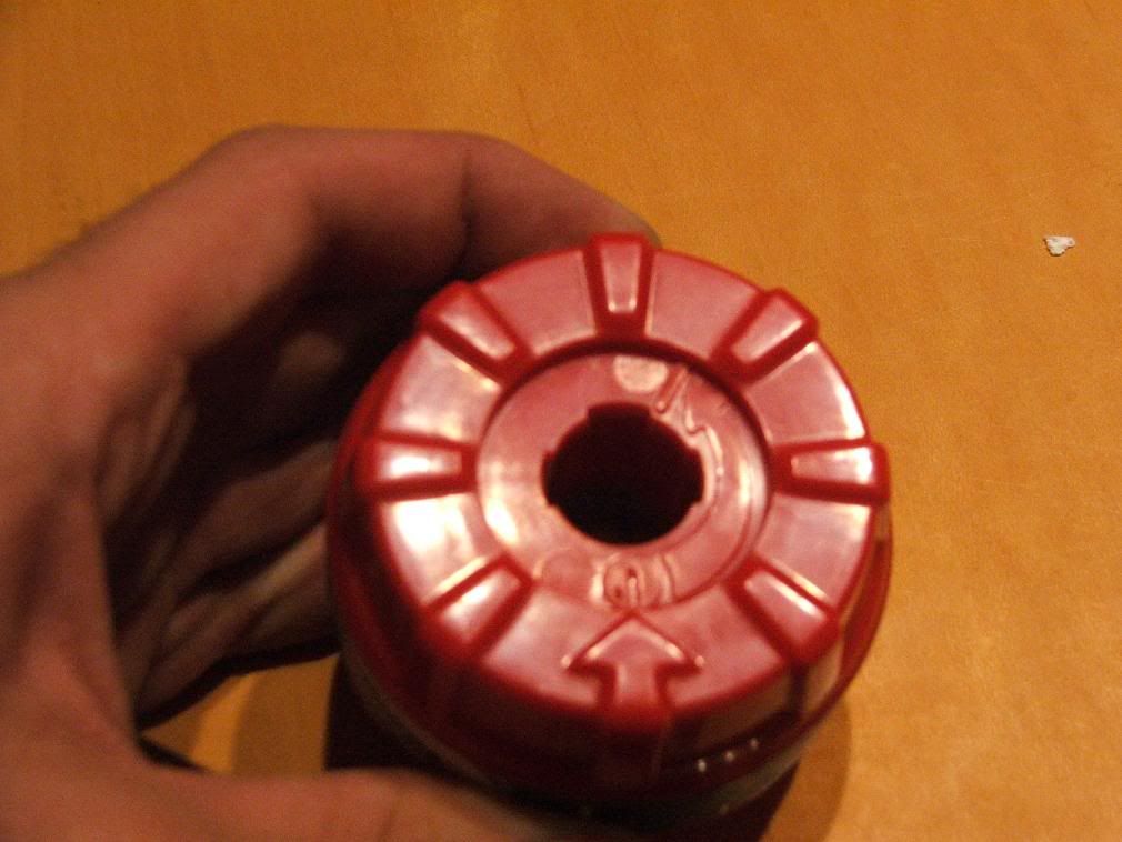

What happends inside the cradel..
Postby dougfarre » 7 Nov 2007 22:08

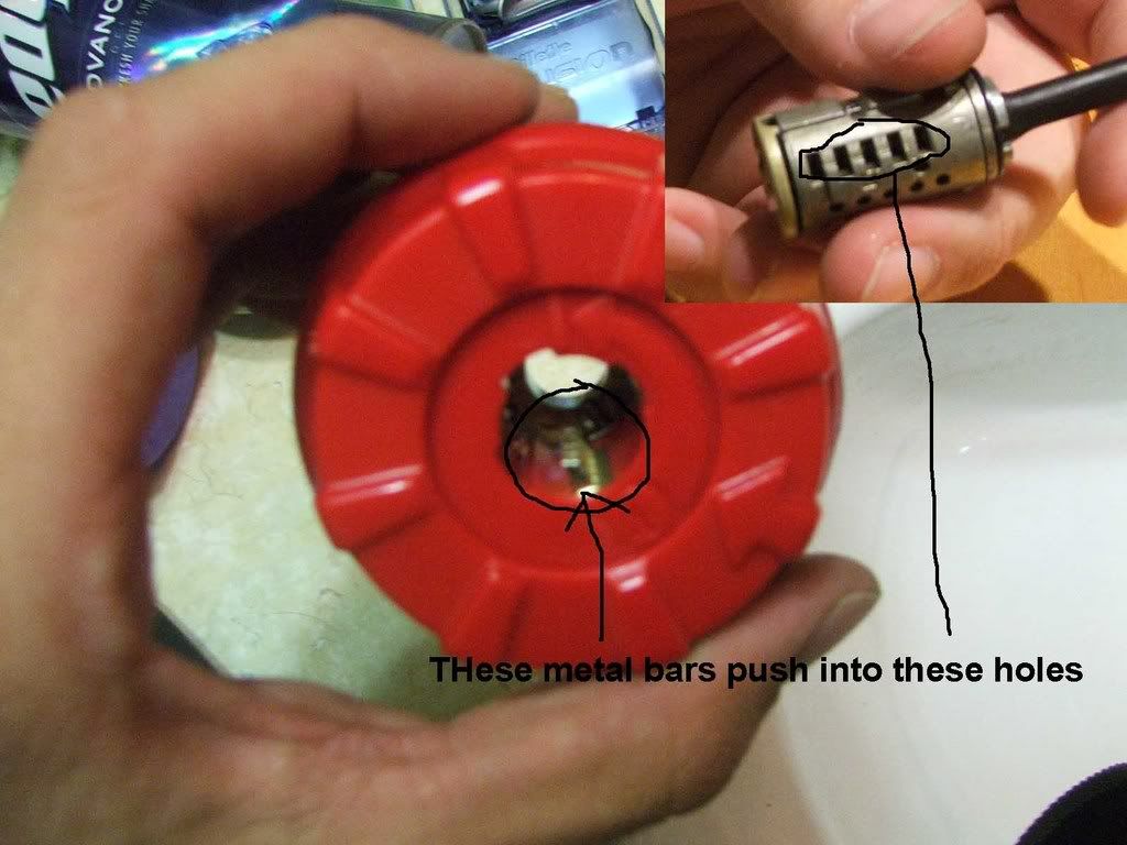

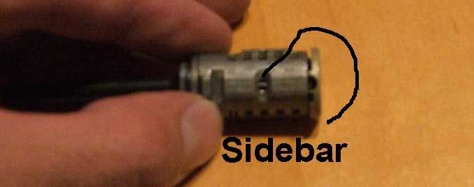

This is whats going on inside the cradle. We have an idea of whats going on with the cradle, but not 100% sure, anyways, you really need to have a Safekey open in front of you to follow along and understand...

Re: What happends inside the cradel..
Postby jgor » 7 Nov 2007 23:45
Now that I've had a chance to think about it, I believe this is what the notches in the opposite side of the safekey's serrated pins are for. The pins are all pushed up to the same height (pretty far up), then the sidebar is pushed in and fits into the notches facing outward on the serrated pins, which are now lined up.

Postby jgor » 8 Nov 2007 13:33
dougfarre wrote:Think you can remove the plug without having to rake the pins.. I am pretty sure with this lock you do not need the key to take the core out.. This is the reason why this whole mechanism is possible... Am i not mistaken?
He's referring to taking the innermost core out, exposing the pin housing / sidebar. It's much easier to do than actually picking the lock because you can pull outward on the inner core to bind the pins on the outer shell without affecting the sidebar, plus you can see the pins themselves sticking out the bottom so you know when you've pushed them up far enough to clear the outer shell.
