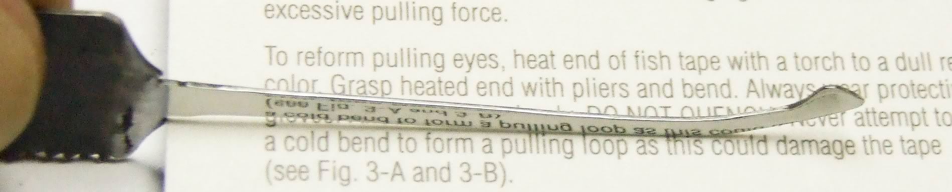

Here's a tutorial I put together on making picks with only a rotary tool and preferable with a vice. It also shows how to get a mirror finish.
Yes I know you can make picks on a grinder (I have one.) This is for those who have a rotary tool but don't have a grinder, or may prefer using the rotary tool.
It's in pdf format here are the links:
Mihd link
Rapidshare Link
Please check it out and give me some feedback!
Here's the end results:
Full size image here.

Very nice tutorial and very smooth mirror finish on the pick :D

Very nice guide, covers pretty much everything.

nice tutorial! 8)
just goes to show what can be made with a hacksaw blade, grinder and a bit of patience.
oh, and some skill :wink:

In all honesty it was quite easy! I'm sure pretty much anyone can do it.
I just figured that there were quite a few people coming to the site that didn't have grinders but had rotary tools and I figured a in dept tutorial would be useful. I tried to keep the materials needed minimal even though I commented on possible variations to the process I used.
All the rotary attachements I used came in the initial kit I purchased except for the buffing compound.
