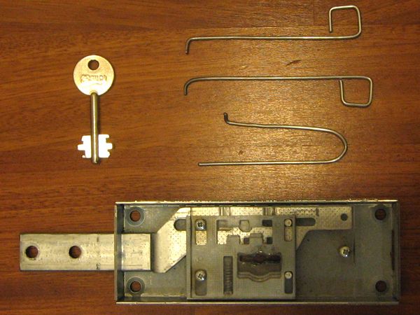

A friend of mine changed his garage lock to open it with the same key of his house basement. This is his old lock, my new one :)
This is not a lever lock but I think it works almost the same. Does anybody know what's the right name?
As you can see I removed one side and made a plexiglass copy to see what happens in the lock. This lock has 6 elements but I can see only the 3 in the upper half, the bottom ones are masked by the bolt. I've already picked it watching the mechanism, but I can't still feel the lock. I know I'm using the wrong tools, but the coat hanger was lying around...
Any idea on how to feel it better?
Thanks :)

It is a lever lock. A double throw lever lock at that. as for feel, it will likely require more tension than you are used to applying with a standard pin tumbler lock.
Re: my garage lock with a plexiglass side
Postby straightpick » 20 Nov 2008 22:23
It's a lever lock, just a different design than the types you normally see. Looks like only 3 levers with a reversible key. You could try a blank with the back portion cut down , leaving just the front portion to engage the bolt and use this as your tension wrench.

I was not sure... now I know this is a lever lock.
I'm using the U wire you can see in the picture as a tension wrench. It's inserted in the keyhole with the tip in the bolt, like a spring. I'll try to use the key filed down, so I can vary the tension.
The key is symmetric: you can use it from both sides. Unfortunately I have to pick all the 6 levers to open it, 3 are behind the bolt.
Thanks :)

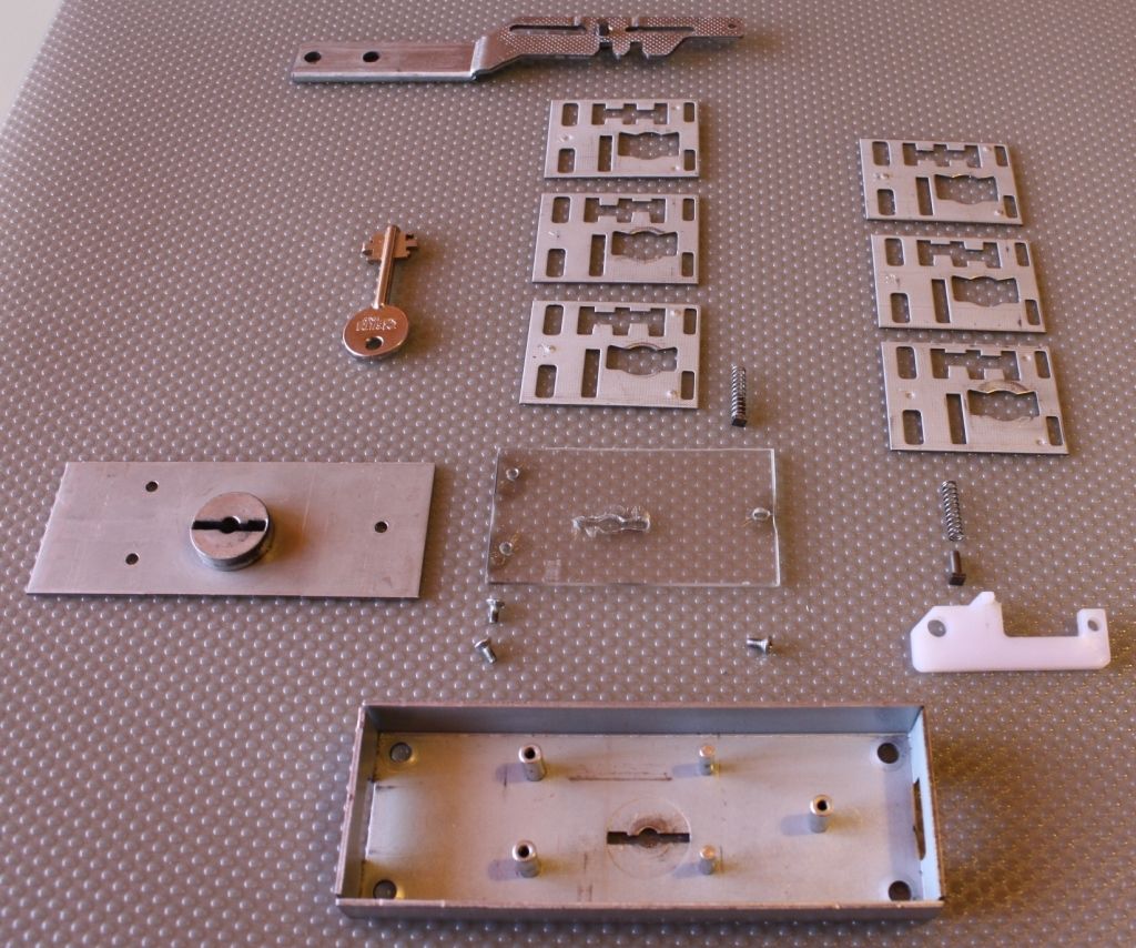

The first picture was enough to understand the lock type, but to help everybody understand how it works I took it in pieces.
It was supposed to be a very secure lock... but once I put on the plexiglass side It became easy for me to pick it. I'll practice some more and then I could put on this metal side again. I hope I can still pick it.
Now my friend who gave it to me is worried somebody could enter his garage without permission. Any idea to make this lock safer?
Thanks to all for your help.

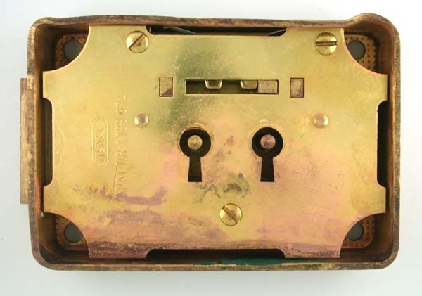

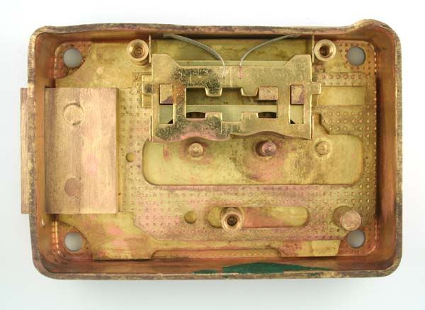

Here is another double throw lever lock made by boda.
Here is an example of a kromer novum single throw lever lock. The locks are of a different design but as you can see a double throw lock, the stump has to pass between two sets of gates in order to open completely.
Here is an example of a nemef dual key double throw lever lock from a power station in The Netherlands (Lock obtained legally). These locks are almost impossible to obtain.
