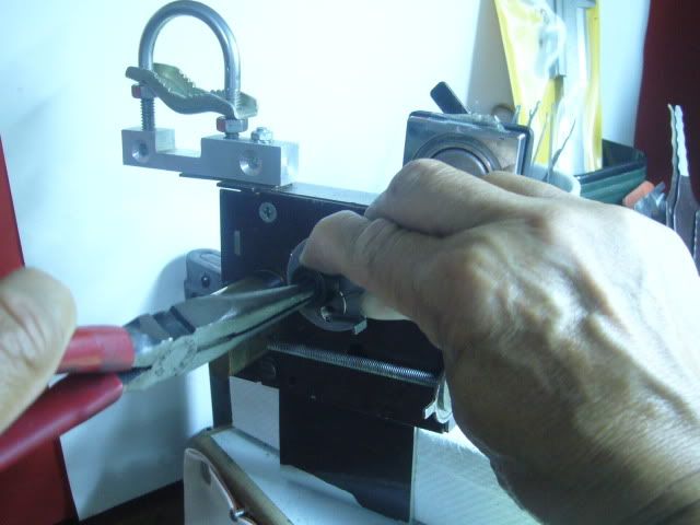

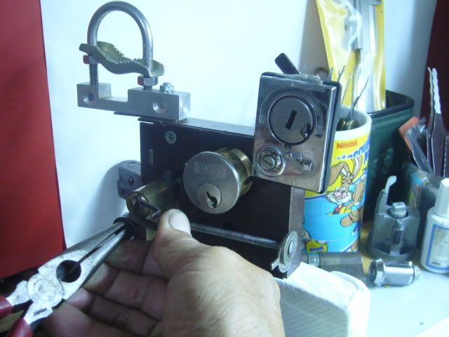

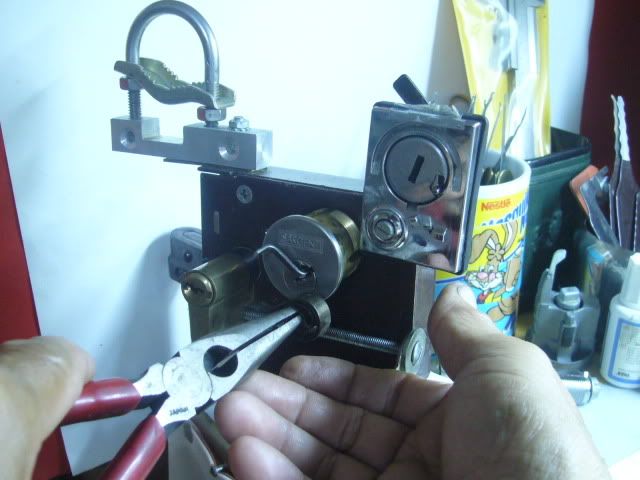

Thinking how to simplify my plug spinner that i want any lcksmith or lockpicking interesed person can easily make for a good reason.. here it is. A 100% effective plug spinner, with only two attachment and a very simple instructions.

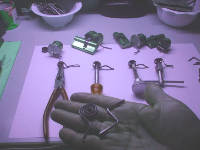

materials--a "Z" 90degrees angle shape tension wire, & a flat coiled spring.NOTE: you can find this flat spring in most mortise locks.make use of these parts when lock is beyond repair. INSTRUCTIONS: (prior to plug spinning) 1.position the "turned plug" nearest to its "JUMP-OVER-HOLE(pin chambers) 2.Maintain at east 1 cm. distance to the positioned "Z" tension wire, prior to your release execution of your flat spring see an easy illustrations using the longnose plier,flat screw driver,a 1/4" square bar, a 1/4" hand tap holder As a hndle. Great hanks to our Moderators for the effort in setting/editting all of these massive pic illustrations.
LONGNOSE, as a handle+Spring+Tension"Z"
