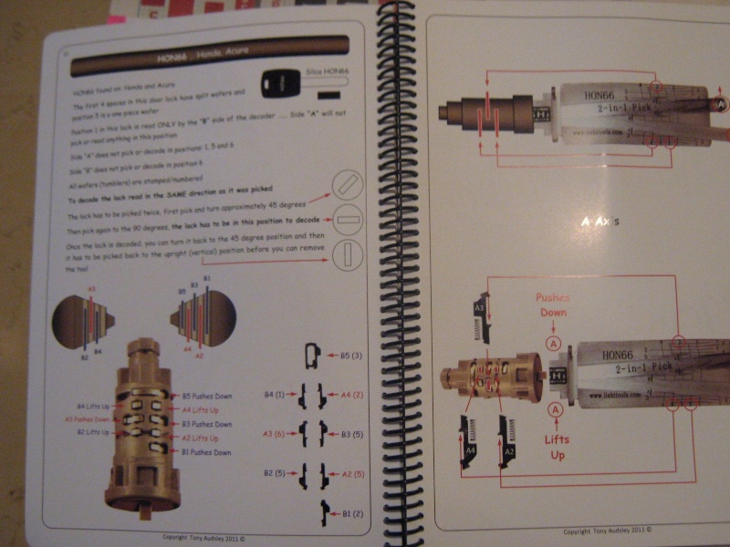

Hello everyone. I'm really hoping that this is an "okay" topic to post about here....
I have looked everywhere about decoding my Honda (High Security) door lock - with the exception of not wanting to purchase the lishi 2 in one guide (I undersand every pick BUT this HON66). But for some reason I can get my lock picked but just cant seem to decode it. I have the key right in front of me so I sorta know what numbers I'm looking for. They just don't seem to match up. I have saw one sketch FROM the lishi 2 in 1 guide. It basically explains that the lock must be rotated at a 90 degree angle.... But it only goes as far as 45 degrees - even with the key. Thats just where it stops....
Take a look at this image:
http://i49.servimg.com/u/f49/12/29/59/48/lian_312.jpg
And also take a look into this forum:
http://webcache.googleusercontent.com/s ... clnk&gl=us
Now I know that Lishi were supposed to make everything easy - as to not having to remove door panels and linkages. Thats what i'm trying to avoid.
Please please tell me what I'm doing wrong. Thank you everyone for your time!
