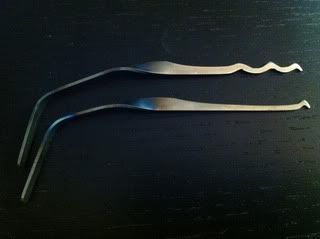

sorry new here, but i do a lot of DIY metal-working ranging from building amp casings, custom parts, and pocket knives, none of what shrub said is true. It's hard to avoid alloys, all the metals you named are some short of alloyed iron, as for titanium,
there's alot of grades of titanium, grade 1-4 are pure titanium, grade 5 to 30-40's (i think? new ones keeps poping up) all model after the grade 5 which is high strength and heat treatable, this is achieved through alloying, grade 5 is named Ti6Al4V which is a mix of titanium, aluminum,vanadium, and traces of iron.
pure titanium: softer and less brittle, better corrosive resistance
alloyed titanium:heat treatable medium to high hardness and strength, less corrosive resistance than pure Ti
danneva wrote:Lock pick tools do not need to be fancy and expensive to be effective. In terms of hardness, stainless steel and titanium are both hard but in corrosion or acid resistance, stainless steel are better than titanium.
I agree with that, but I personally prefer Ti grade 5 (aka Ti 6-5) since you can basically work with it as if it's steel, annealed state offers relatively good machinability, and when heat treated, can be as strong as steel or stainless. Another advantage is that titanium offers better wear resistance, meaning your hard work of DIY or cash that you paid gets more use out of it before they wear out.
and quick correction, titanium IS more corrosion resistant than stainless steal since titanium forms a layer on the surface that protects it from anything corrosive. (http://pubs.acs.org/doi/abs/10.1021/ie50521a054 hit next page and read the top paragraph)
anyways, it really comes down to preference, even the strongest titanium will break if you man-handle it since picks are made so thin and small.
here's what I made out of grade 5 titanium. its a work in progress (top piece still need to be sanded and polished)
tools i used:
dremel - cut-off wheel (one made for steel cutting)
files and sand paper
