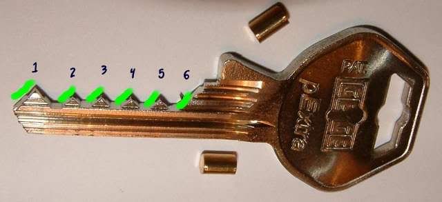

jimb wrote:Don't waste your money on 6 pin bumpkeys. A 5 pin key will bump a 6 pin lock. If you get a 5 pin Schlage and Kwikset it will open about 90% of US locks.
how exactly will a 5 pin bump a 6 pin? Wouldn't it be a 6 pin bump a 5? And I am sorry for the double post, I don't think this forum has a post edit button.

Postby jimb » 29 Apr 2007 18:32
The ramp at the end of a 5 pin key will bump the 6th pin.

Postby cjames73 » 29 Apr 2007 18:33
the slope on the front of the key will bump the 6th pin.
sorry for the crap pic :oops:

Postby n00bking » 29 Apr 2007 18:57
2 questions. why do places sell 6 pin bump keys?
and, why are on bump keys that last pin thing (i am a n00b) is a lot higher than the other ones.

Postby cjames73 » 29 Apr 2007 19:12
1) i think the reason for companies selling both 5 and 6 pin keys is for more sales and therefore more of your hard earned £££/$$$
2) the inner peaks are lower as both sides are filed to a 9 cut, the end is only filed on one side.
if you file the outer edge all the peaks will be the same height.
