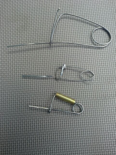

Postby Kheops » 9 Jul 2014 19:07
What not to use:
Thought it MIGHT do the trick... problem: too small, and spring loses ALL of it's strength almost immediately.
Today, I did try stainless steel welding rod, and I must say I'm pleased with the results. My third try at snap picks and I managed to pick a whole bunch of cheapo deadbolts.
Maybe just a little too big.

Re: How to Make a Snapper Pick by Sams Choice
Postby GWiens2001 » 9 Jul 2014 20:22
Nice creativity using the tea strainer. Only problem is that now you need to make tea to relax from the hard work, and your tea strainer no longer strains tea. :lol: Glad the other ones worked well for you.
Posts: 7680
Postby Kheops » 10 Jul 2014 3:40
Thanks Gordon,
It seemed like it might be the perfect material. Costs next to nothing, already has the right shape, stainless steel, right size, and is a spring... but no... The spring really loses it's strength way to quickly. I got maybe 3-4 good bounces from it. Now the end doesn't even touch the bottom of the "box" (the part that traps the pick).
I really have to get my hands on some bike spokes! I am impressed at how well these little things work on cheap locks.

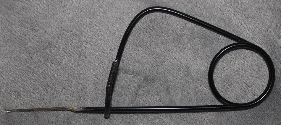

Postby Kheops » 25 Jul 2014 16:09
I finally tried with some bike spokes. The problem, I believe, is that my spokes were too short, so I was unable to make a snapper that was a useful size (and I have small hands!)
Then, the other day, while I was at Walmart, the clouds parted, and a beam of light came down from the sky, I could hear singing...
It's a fish mouth spreader. Here it is deployed:
I thought, PERFECT! Here is my rough snapper, still needs to be sanded and polished, but already it works amazingly well. It snaps very hard, the spring is extremely strong, as a matter of fact I really had a hard time bending to my desired shape.
Have tried it out on a few cheapo deadbolts, and already have quite a bit of success despite it being very rough and having a lot of friction.
I will clean it up a little and post an update.
