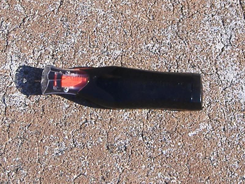

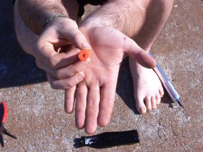

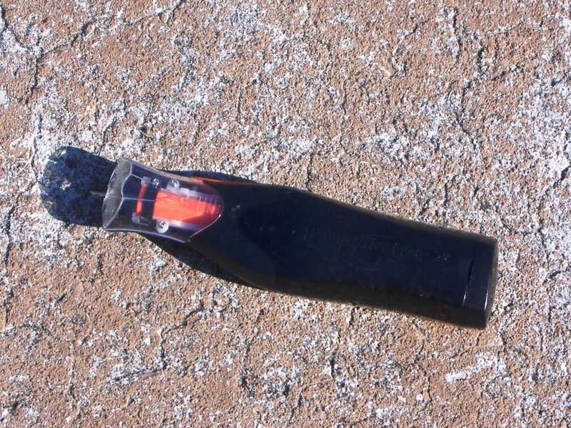

Postby Knows-Picker » 8 Mar 2007 13:59
ok, here is the closest thing that I have made with about 90 percent sucsess rate that uses the same theory. I use a standard L rake ( the one that is long and has about 6 little humps on it) and a
*****Drum roll please*****
battery operated pumpkin carver. You can only get these around halloween, so when october comes around, pick up a few of them as they are excelent tools for several uses and only run about 4 dollars for the tool and 6 tips.
The one that I got has a pumpkin carving "tool" inserted into a recipricating end of the the tool, and when you push the button it works like a mini sawzall and cuts the pumpkin. What I did was take the pumkin carver apart, take the carving tool out, and then insert a L rake into the holder of the carving tool. Re-insert the peice into the handle, and voila! You now have an electric rakeing tool. I have 2 of these that I use, one with a L rake and one with a W rake.
I also use a 3rd tool for sanding my home made picks. What I do is when I am at the final stage of pick making, I put it into the pumpkin carver with the pick sticking out of it. I thin fold a peice of sand paper over the pick so that it is contacted all the way around and then hit the button on the pumkin carver. This will do the sanding of the pick in about 1/10 of the time that it usually takes, and is a great way to finsh off your picks.
Hope this gives you a little help.

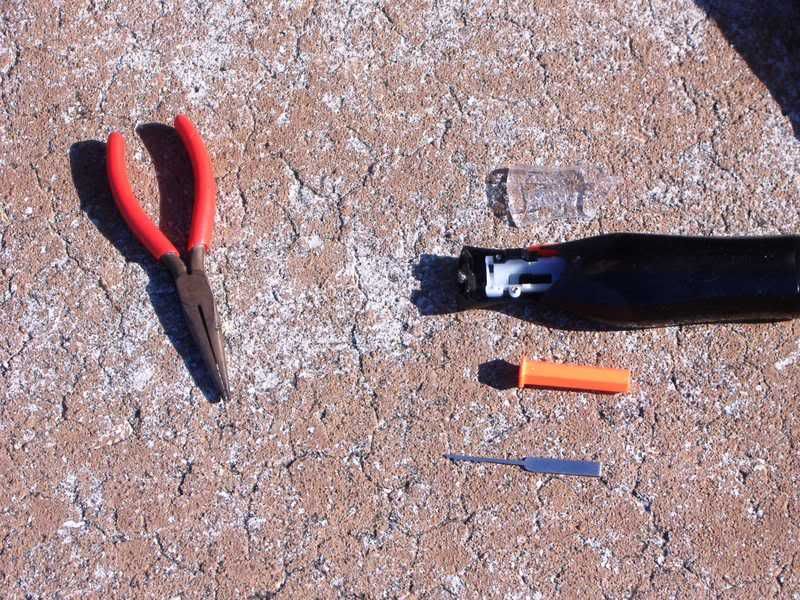

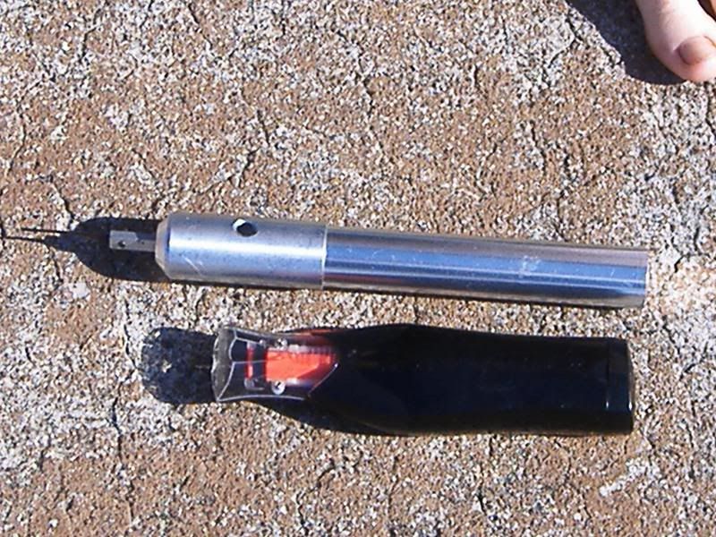

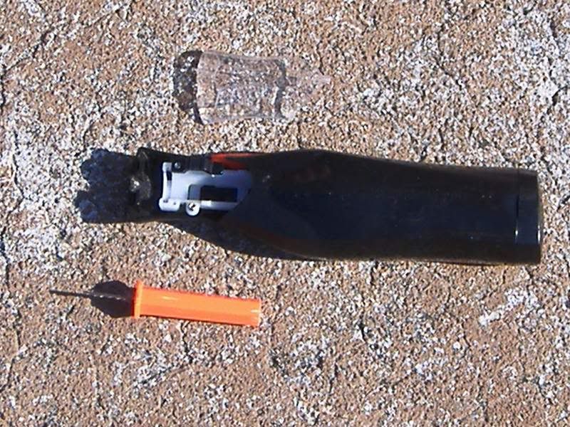

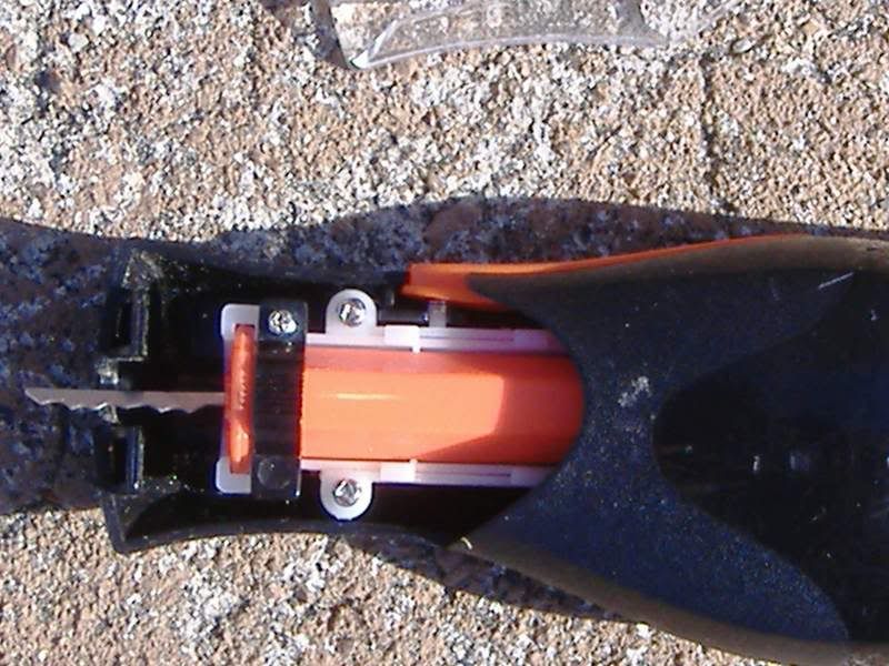

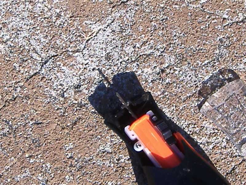

Postby Knows-Picker » 11 Mar 2007 16:52
Ok, here are the pics that I promised. The first one I have placed the south-ord electric pick (3 "C" cell size") next to the pic only for a size refference. Hope that this works, I am using clickable thumbnails from photo bucket. have a look.
