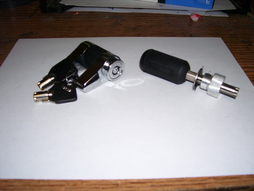

Postby jimmysmith » 25 Jan 2007 19:47
never has to much of a problem picking tubular locks with my southord tool. ... I have even opened ace II with it..
for me its the greenwald locks that stump my tool a little.
