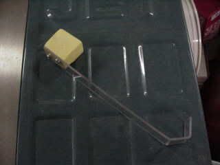

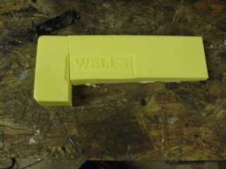

If you are interested in making a bump hammer, here's how I made one.
The head is made from a plastic wood splitting wedge purchased from Northern Tools for about $5.00. Take a hack saw and cut a square off the thick end, you can easily make 2 and have most of the wedge left.
http://i126.photobucket.com/albums/p112 ... /wedge.jpg
http://i126.photobucket.com/albums/p112 ... memade.jpg

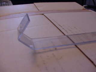

I went to Lowe's and bought a 8"x10" sheet of lexan plastic, located in the glass replacement section of windows and doors.
It cost about $3.00, I put it on a tablesaw and cut a strip about 1" wide, cutting length wise. You can easily get 6 handles out of one sheet of lexan.
Then I heated the end with a heat gun and bent a 90 degree bend about 3/4" from the end, then heated it again and made a 45 bend about 3/4" from the first bend. photo at
http://i126.photobucket.com/albums/p112 ... handle.jpg
The homemade one works good.
