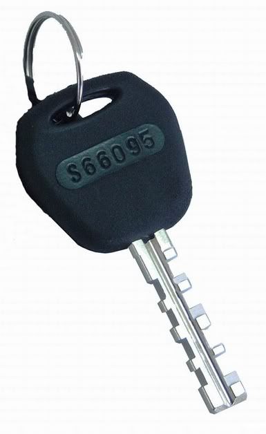

how about my key????
Postby UWSDWF » 29 Sep 2007 15:27
Can anybody tell me where I went wrong with my bumkey? It just won't work :x

Re: how about my key????
Postby Wrenchman » 29 Sep 2007 20:07
UWSDWF wrote:Can anybody tell me where I went wrong with my bumkey? It just won't work :x
Did you remember to take off a little, of the shoulder?
:D
Postby vrocco » 29 Sep 2007 20:27
Hmmm......looks good to me. Don't tell me you still can't bump that abloy?
:lol:

Postby Marco » 30 Sep 2007 0:19
UWSDWF, maybe you should give up trying to bump the abloy and use the key for something more useful. It looks as if it would be very handy if you need to scratch inside your anus :lol: Need instructions? Just stick it in and keep turning!
Let me know how it goes :wink:

Postby Eyes_Only » 30 Sep 2007 0:47
LOl, thats the best picture from you yet UWSDWF. :lol:
