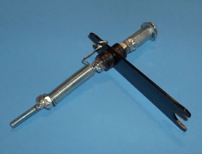

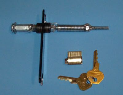

Hi everyone.. Today I made my first plug spinner its not totally complete my grinders not working so I still need to grind down the end to fit a keyway. I made it from 1- 1/4"x4" bolt, 6 thick black 1/4" washers, 1-1/4"
grey washer, 4-1/4" nuts, a cool wrench I had, that I drilled a hole in for a handle, 1-1 1/2" spring and solider. You can find all of the stuff at home depot or any other hardware store.
Thanks for looking..

Postby Safety0ff » 8 Jun 2008 17:35
Has anyone tried using the springs used for lawnmowers? They usually sell replacements. I had a similar idea some time ago, never finished it.

Postby assweasel » 8 Jun 2008 19:50
Nice Stevo.
Not sure if i am more impressed by the work or intimidated by it.

Postby Legacy712 » 28 Aug 2008 3:48
Nicely done with spare parts.
I guess you spin the top while you hold the black lever, then let go of the top to let it spin, right? Is there some sort of locking mechanism to lock the top when you're tightening it, so you can let go of it for awhile or preload it?
