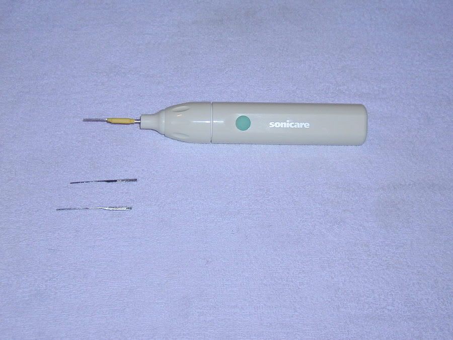

has anyone tried to make a pick out of the sonicare toothbrush. It seems like it would really bounce those pins.

Ive tried it. I had a worn out brush head, so I cut it down and installed a sewing needle. Had no success with it whatsoever, it vibrates well, but the motion isnt large enough. If you worked on the head, trying to get a larger range of motion (bouncing the needle as opposed to just letting it vibrate), it may work for ya.

If you made the needle longer wouldnt that make the range of motion larger ? Or maybe make the needle have a bend in it a bit like the standard snap gun type thats available.

I tried this as well, I found that it didn't work at all. If you get too far away from the head you end up loosing a lot of strength- it barely moves the pins.

A friend of mine was able to modify one of those generic electric toothbrushes to surpass the speed of a sonicare by stacking batteries and doing a little rewiring. I'll play around with making a pick out of it, because it's pretty much useless as a toothbrush now (it could tear your gums to shreds).

The older toothbrushes seem to have more up and down movement. I could get my old one to open simple locks but never anything above a quickset.

thing with a sonicare is its not a direct drive - just magenetic-mechanical, a computer controlled electro magnet determines the vibration, so I think it would just *even if you had the strength and range of motion* too fast.

frollard is right on. The brush is stuck onto one end of a very stiff spring, with a couple of very strong magnets at the other end. The magnets are close to an electromagnet coil that's driven at high frequency by a microcomputer chip. The spring is designed sort of like a tuning fork, and resonates at the drive frequency. The mechanical resonance depends on the weight on the end of the spring, which is the plastic brush. So if you experiment with replacing the brush with a pick you should try to keep the final weight about the same, else the resonant frequency will change and it won't be excited into vibration very well by the coil.

It worked pretty well on nearly all all lower security locks I tried it on, but not as fun as doing it manually. Further reading
