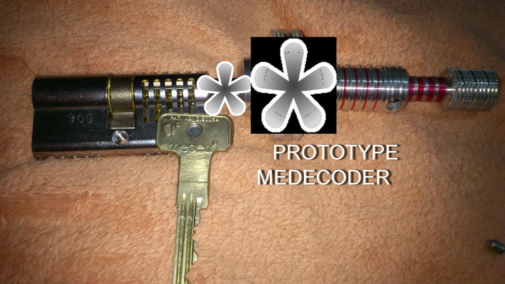

Postby Vetal » 5 Oct 2015 13:54

Postby Squelchtone » 5 Oct 2015 13:58
Vetal wrote:Image Hi, your technical assistance on the lock is necessary. Thanks.
Which Medeco keyway did you make your tool for? and does it set angles or just bitting?
Looks very interesting!

Postby Vetal » 5 Oct 2015 14:02
Thanks,
Squelchtone does it set angles or just bitting
