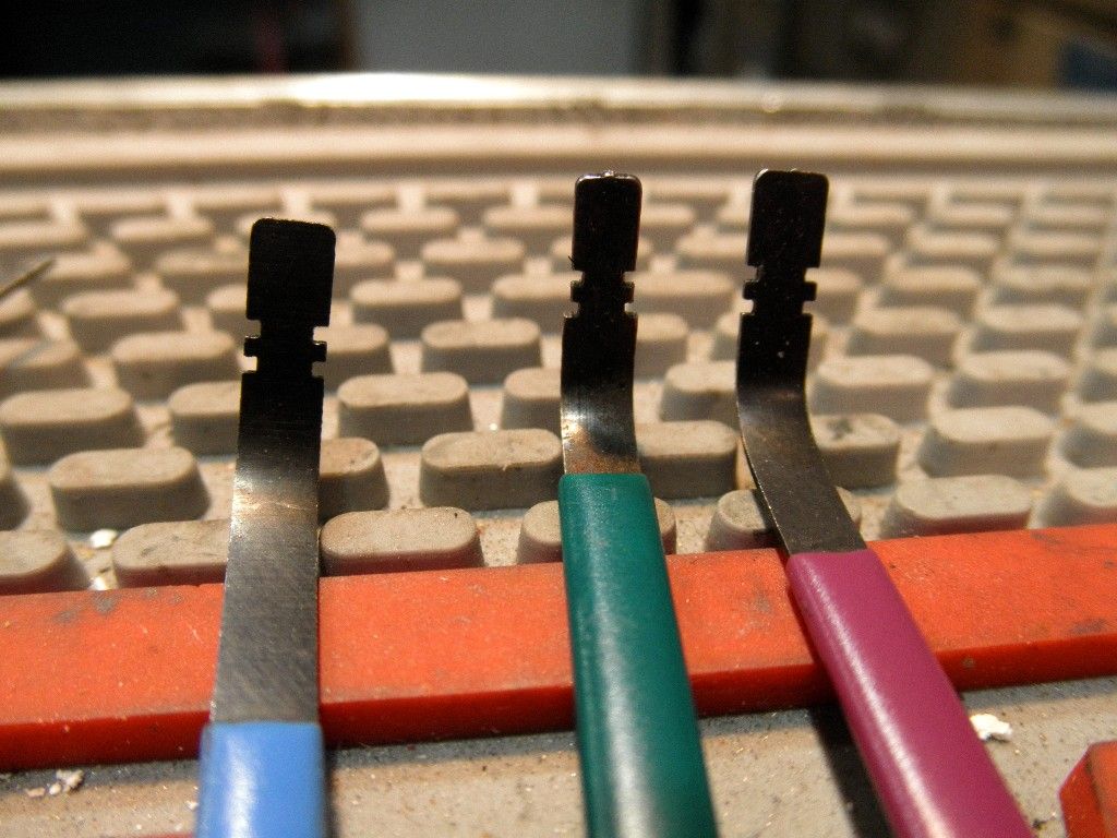

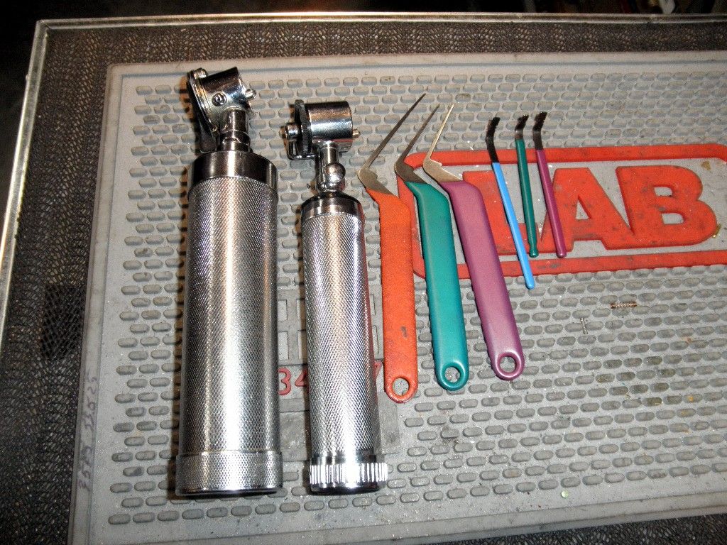

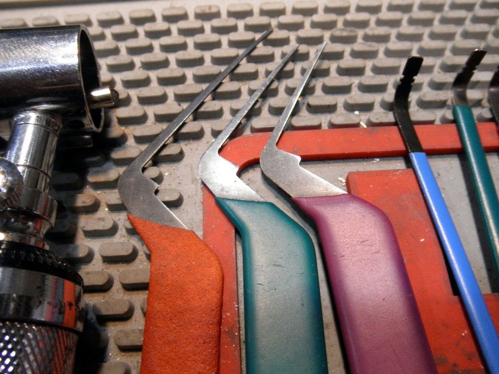

My scopes get used daily.
I now use a feeler pick made specifically for reading wafer locks. BIG help.
When you use a normal half diamond pick to read wafers,
the ass-end of the pick gets in the way of the scope.
The tension wrenches you see to the right, are made to
keep the shutter door open, Very useful.

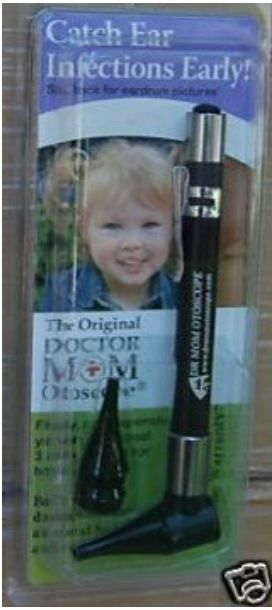

Postby escher7 » 28 Mar 2013 15:06
Dr. Mom's Otoscope on Amazon. $20.00. Can't lose.
escher7
Posts: 21
Joined: 11 Feb 2013 13:59
Re: got any opinions on scopes?
Postby LockDocWa » 28 Mar 2013 21:22
Is this what you are referring to?
I might question durability....Bulb replacement availability...and overall visual quality.
It may be fine for a hobbyist.
