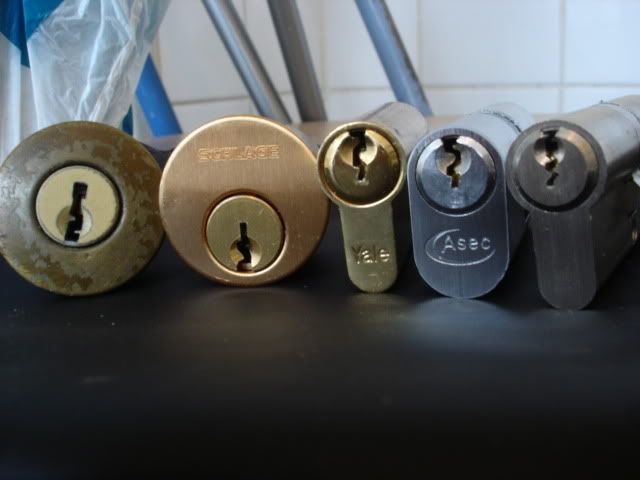

Slimlines are designed for locks with very tight keyways... take a look at this example. From left to right are Kwikset, Schlage, Yale, Asec, and EVVA. You need slimlines for the latter 2 because they're so narrow and jagged, but you can pick the others with standard picks just fine.
You're not gonna come across many locks that you can't pick with standard size picks, especially in the US. So for the most part the slimlines you bought are unnecessary... there is a good selection of hooks and offsets there though, so you've got plenty to experiment with and you'll find 2 or 3 that you really like. Just go easy on them, you can push them every now and then but if you're heavy handed in general then they won't last long.
In all honesty though, the ones you had were fine. Cheap doesn't mean rubbish, I have a set of picks which I got off DX for $5 and they're surprisingly nice to use. I actually find myself using them more than my petersons, which is a sin... but they get the job done. And out of that cheap set I have one hook I like; I don't need to reach for anything else 90% of the time. Buying a bigger or more expensive set of picks won't make it easier. Practice, patience and understanding will. Take your time, concentrate, know what you're doing - and then you'll know what kind of picks you need.
