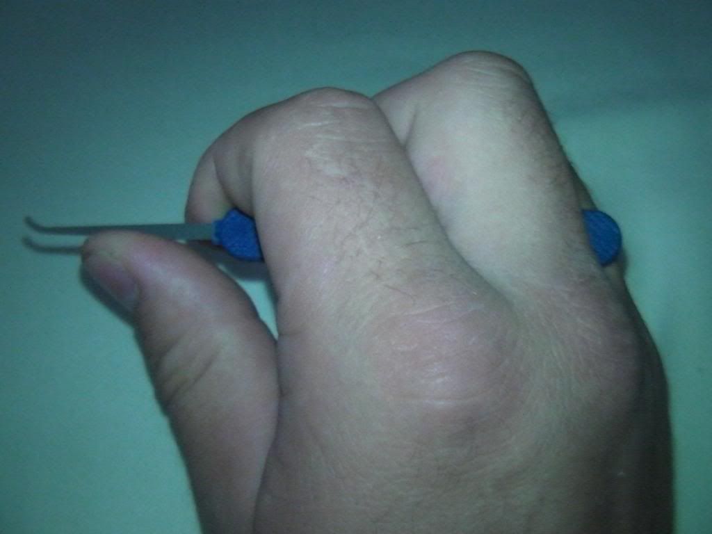

When my hands are really sore for various reasons, it can be very painful to pick a lock. It takes some getting used to, but I have found that holding the pick handle between my index and middle fingers (resting at the point closest to the joint) and resting the pick itself on my thumb has helped me not put too much stress on my hands (I use my thumb to manipulate the pick.) Of course, pain is unique to everyone and everyone has different sized and shaped hands, so this may not help you at all (my grandfather gets his arthritis directly in his thumbs, and thus this may not help him.) Here's a picture, except I rest the handle between a different pair of fingers.

My arthritis (like your grandfathers) is in the thumbs. Pain and weakness
But thank you for the suggestion.
