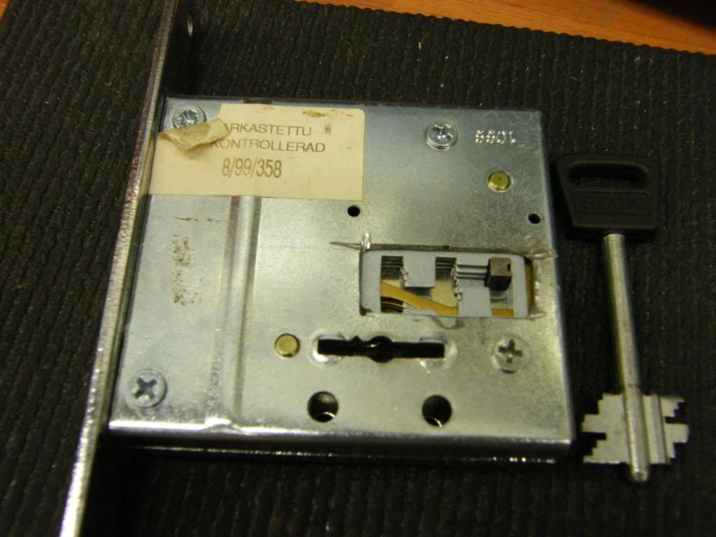

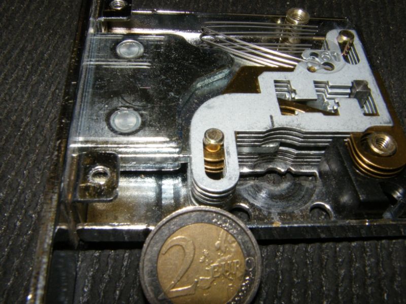

This is the most common deadbolt that we Finns have above our Abloy locks.
The name "boda" comes from Björkboda lock factory, est. 1732, still in business.
Boda is the old brand name, Abloy bought them, and the lock became Abloy 429.
Its an 8 lever lock with the bolt in the middle. You need a full 360 rotation to open the lock.
After successfully picking a couple leverlocks, I wanted to try this.
I know its way outta my league, so I made a sorta halt-cutaway. Half because the bolt hides 4 levers behind it.
There is a self impressioning tool for this lock, but it propably is considered advanced tool, so I would ask to post stuff like that on advanced forums.
My wires are really crude. :wink:
Anyhow, pictures:

Badly worn keys don´t open this lock, so I don´t usually see many of those.
Bigger problem with keys like this is bent/snapped bit on a key. Depending on cuts, just dropping the key on floor could bend or break the outmost bit.
I can´t cut these to code, so if one bit is broken, I copy that one bit from the other side of key. -The keybits are mirror image of each other.
