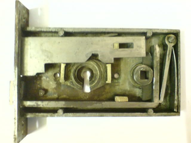

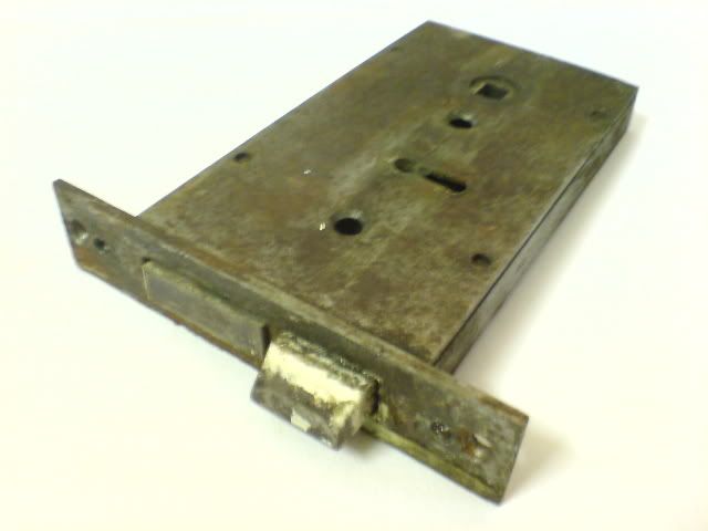

Here it is straight out of the door. Some of the screws had to be dremeled loose because they were so rusty:
And with the front removed:

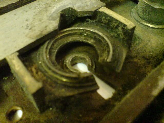

Here we see the warding, which makes me think the key might've looked something like this wonderously creative artists impression ;)

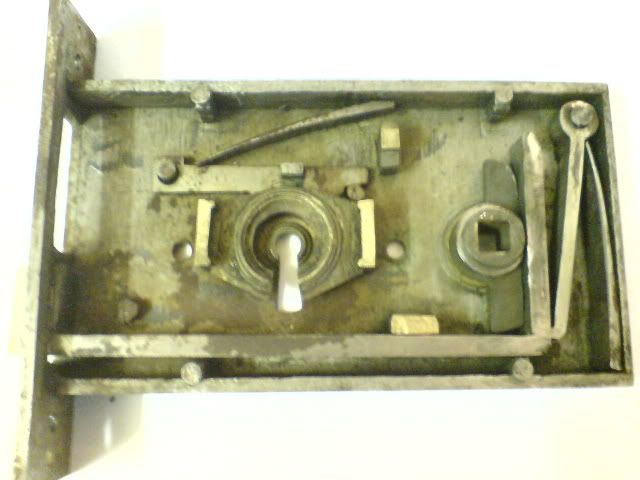

The bolt removed and a bit of a clean, revealed a single lever. There is an appropriate nodule on the reverse of the bolt and no "gate" as such so the lever only has to be lifted far enough to clear it. There are no measures to prevent an over-lift apart from the insanely tensile strength of the spring.

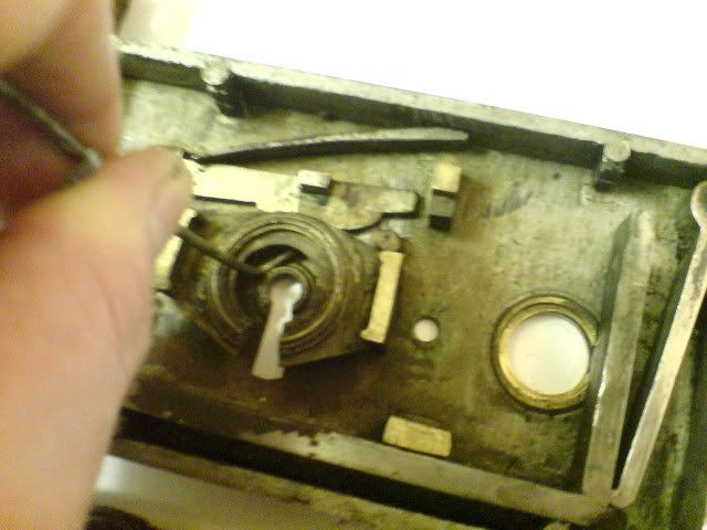

The next photo shows how I was just about able to operate the lever with a bent spoke and take a pic at the same time:
The thing that surprised me was the amount of force necessary to lift the lever, without taking it apart I wouldn't have known to push that hard.

Its not actually a lever lock. What you refer to as a lever is just something that holds the bolt in the closed or open position. The peg on the "lever" locks in a slot on the back of the bolt. The key lifts it enough to clear the peg from the slot.
With 2 small hooks it should be possible to manipulate the lock. One to lift the 'lever' and a second one to throw the bolt.
Hope that makes any sense , I don't really know the English terminology. :roll:

I found it is possible to manipulate with bent bicycle spokes but the spring is very tough.

Making the key won't be too hard but will take a lot of filing. The artist impression is good but it looks like it needs to be inverted, the ward cuts will be on the outside on each vertical edge of the bit not on the inside.

It seems the security in this lock is in its wards. Union makes a similar lock (Rim lock) to this in SA but it is mostly used for outside gates etc. Security not that good.
This key should be like a step down with the top of the bit being the widest .

The key would be like the image he posted , but with a bit more meat on it. The key in the drawing would break very fast.

At first glance I thought the warding was flat against the case. Hadn't seen this type of floating ward.
