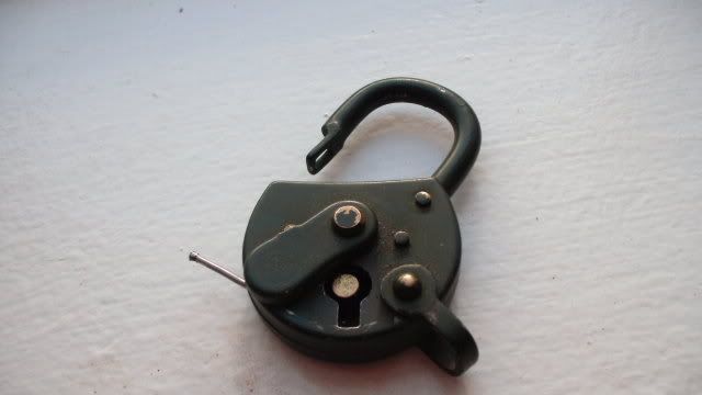

I have picked this lock but found it to be awkward and difficult. I had to hold it in a vise and use two picks inside. I needed a third hand. Is there a more professional method for picking this lock? Is this one that a common 2 in 1 would be used?
I think it has five levers plus the bolt. Please clarify and correct me. I do not want to cut it open.

I'm pretty sure your lock was manufactured by the German company "Burg Wächter" and I have a 4-lever padlock which is probably very similar to yours:
Since it is a lever lock which you preferably pick with a Hobbs pick, there is no other way than to use 2 tools. One to tension at the back and one to lift the levers. These locks tend to have very strong springs so maybe that's what made it awkward for you.

I often see these locks. They are often used on the beach. The flap prevents sand from entering the lock.
We can copy these keys , getting the keyblank isn't that hard.
Most of the ones i see are from ABUS. They are a bit different to the one Scholls is showing. In the Abus lock , there are 2 levers that block the shackle.

My padlock was given to me by a German soldier who had lost the keys. I have blanks that will fit and believe that it is a key retaining padlock. This means that I can very easily impression the key as the levers are frozen in place by the bolt fence.
