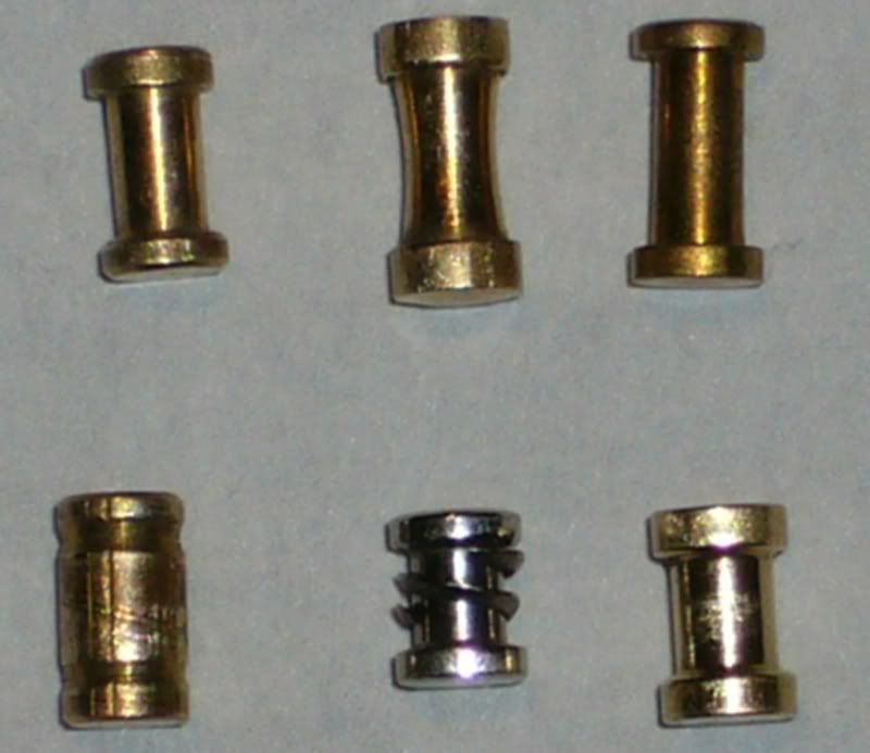

I'm sitting here with a OLD 5-pin RUKO lock that
I have rekeyed, to use shallow top pins.
(Will post a pic later on)
I tryed to search for a topic about this, but could't find anything,
explaning what the solution to my problem could be, I've read a few guides to feel binding pins, mushroom pins, and so on and so furth..
The problem I have is that I just can't pick the lock with more than 3 pins in it. It's taking the better of me.
Any advice ?

Are you talking about pins that are shaped like this?
If so, you're talking abouts security pins, sometimes referred to as spool pins (like a cable spool).
On hints how to pick those search for these terms (security pin, spool pin), there will be lots of threads with good advice. The basic gist is to allow the plug to rotate back a little against you tension direction. This might cause you to lose other pins that are already set, so you have to redo them. All in all, these are a pain at times (when there are many) but once one has gotten it a few times it becomes routine.

Here Is the top pin. Used in any medium security lock.
http://technet.20m.com/Ruko_top_pin.jpg

Postby unbreakable » 8 Aug 2006 11:28
Wow, that top pin is definetely a security pin, but its a shape Ive never seen before......
You might want to get a lock without security pins to practice on, if not just keep trying, you'll get it eventually.
The problem with those pins is that they will false set, meaning it feels like they've set but they haven't.

Postby p1ckf1sh » 8 Aug 2006 11:37
NeXoz wrote:Here Is the top pin. Used in any medium security lock.
Oh, nice. That kind of pin will not likely be too hard to pick, it has no lip that can really hard.

Postby NeXoz » 8 Aug 2006 11:39
You got darn right..
Those pins are killing me..
I have a bunch of keys and locks+pins (both top and bottom)
But I can with ease pick a regular 5-pin TL (tumbular lock)
that has regular straight pins..
So i moved up a notch the security line..
Have you seen this pin before?
http://technet.20m.com/Ruko_top_pin2.jpg
this is what is used in top security ruko locks.
Ruko Garant 10..
Etc..

Postby NeXoz » 8 Aug 2006 11:44
p1ckf1sh wrote:Oh, nice. That kind of pin will not likely be too hard to pick, it has no lip that can really hard.
hehe.. It is VERY hard.. But I found it to be possible.. with a feeler pick,
and a short tension wrench.. It takes time but i've done it with 3 pins in,
(all the ")(" shaped pins..) took me about 10 min.. And a LOT of resseting
the lock.. hehe..

Postby unbreakable » 8 Aug 2006 11:44
That looks nasty too mate, sure beats the #ell out of our kwiksets. You guys over there just seem to have a much higher security standards.
Good luck with it :P :P
