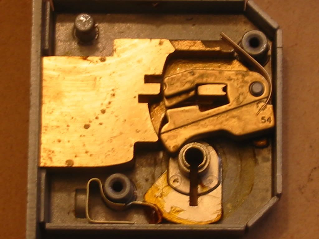

Canadian lever lock
Postby cjames73 » 14 Apr 2007 15:16
make another pick to put tension on the bolt thrower.

Postby JackNco » 14 Apr 2007 15:19
one wire goes in and puts tension on the bolt. then with a second wire you then lift the levers as they bind. after its finished binding it should go lose and have a couple of mm play in it, then that lever is set. some times you will life a lever once and it will bind sometimes it will go a little bit and another lever will start to bind.
Although ive only picked a couple of lever locks a few times so im no expert on them.

Postby keyman » 17 Apr 2007 14:08
You might find this a little hard to pick for a first lever lock 3 lever locks are easier to pick than 2 lever as the bolt tallon is quite thin and the pick tends to slip off ,where as a 3 lever bolt talon is thick in some cases 3 times the thickness as one lever therefore the pick used as a bolt thrower stays in the space ,Maybe its just me but thats what i found when i started out .

Postby Shrub » 17 Apr 2007 14:15
I still find centre thrown locks a pain if they are badly worn as the throwing part simply is too rounded and a wire wont stay on it,
I solved it by grinding a v in the end of the wires and they grip very well :wink:
