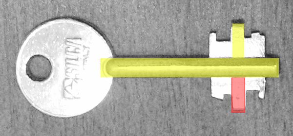

Time is passed since I started playing with this lock, so I decided to make better tools. First of all I bent two bicycle spokes to make stiffer picks. Easy.
Now I want to file down a copy of the key and use it as a wrench. What is the lower limit to keep? I guess I just need the shaft. Is it enough to keep the yellow part or It's better to keep also the red one?
Thanks in advance :)
Re: my garage lock with a plexiglass side
Postby weerwolf » 4 Feb 2009 17:01
You really need just one of the two sides. But if you want to pick the lock when its locked twice , you will have to turn the "key" almost 360° , if you leave both sides , you'll only need to flip the key almost 180°.

Postby femurat » 5 Feb 2009 3:58
Thanks weerwolf, it could be an easy guess but I preferred to ask before cutting.
I'm going to keep just the yellow part: I don't mind turning the key 360° if this can give me more room in the keyway.

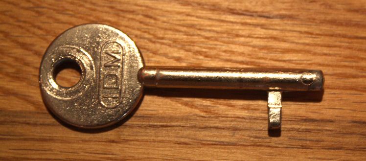

Postby femurat » 7 Feb 2009 5:38
So this is my new wrench. It's a lot different from the wireframe one I used before.
I'm looking for another lock to practice with and when I'll find it I'll need different tools. By the way, does anybody know why it's so hard to find an ERA profit? I asked in the buy sell trade area but nobody answered...
