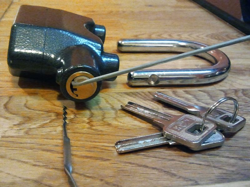

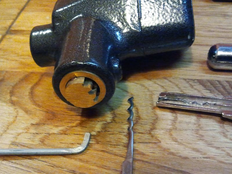

Postby femurat » 18 Jan 2013 5:01
I was looking for one of these locks for so long and when I got it I was very excited. I was imagining the strange tools I may have had to make in order to defeat this very clever design.
To tension it I inserted a bent wire and pulled it with index and thumb while the lock was in my hand.
It was not easy to control tension, but it was the easiest way that came to mind.
I tried an half diamond for a couple of minutes but wasn't getting any feedback, so I decided to give it a shoot with a very small bogota.
It took me just a few minutes to pick it. I was astonished. I took a few pictures of the lock to show off, since I was afraid it could have been just a lucky opening.
After taking the pictures I closed it and picket again in one minute and a half. The plug turned a bit at a time while the pins were set. It also came out so I had to be careful not to push it in while tensioning.
A bogota is the way to go with this lock.
