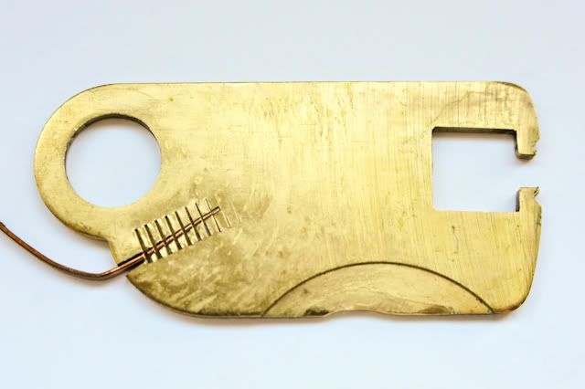

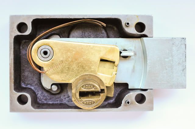

Postby MacGyver101 » 14 Jan 2013 17:17
mmcc wrote:As for the lever bellies, they are not generally flat as you suggest, each lever has a unique shape and rest position depending on which code it is for.
Hrm. That's not usual... or, at least, that's not usual for lever locks made in the past couple of hundred years, or for modern ones that are well-constructed. Let me try to explain...
These images were shot for another project, but they'll help to illustrate the point. This is a double-bitted lever lock, with the cover off so you can see the levers in their "rest" position:
When there's no key in the lock, you can see that the bellies of the levers (i.e., that part of the levers that interacts with the key) are smooth and flush with one another: there isn't any sign from measuring or looking at the bellies of the levers how much the first lever should be raised relative to the second or the third... they are all cut to the same shape and curvature where they meet the key.
The difference is where the notch is cut in the lever, to allow the fence to enter and the lock to open. Here's an example from an old safe lock:
It's a little harder to see, but when there's no key in the lock, the bellies of the lever are all resting at the exact same level. Here's a picture of two of the levers sitting on top of one another:
The curved sections that contact the key (bottom right) are identical, but the cuts in the lever (just above) are different. The key pushes the levers out of alignment to open the lock:
Here's one final example (and sorry: the levers are facing opposite ways in the two pictures). The levers in this Folger Adam all have the same dimensions, and are cut the same where the curved part at the bottom interacts with the key:
The only difference is where the cut is made for the gate to enter. You can't feel or see from the keyway how high each lever needs to be raised -- and the key needs to raise each lever by a different amount.
If that wasn't the case -- and if the bellies were all cut to different depths -- then you could do exactly what you're proposing... you could measure the different positions of the levers at rest, and you could then just find a way of lifting every lever by a 1/4" to open the lock. (You could also just start with a blank with wax on the side, try turning it, and file away anywhere that the wax had been indented... this is the approach for very old warded locks.)
Now, not to confuse the issue... but the sort of approach you're proposing does have a bit more application for standard wafer locks: there are a number of tools that exist for reading/picking those (in particular when it comes to automotive locks) that are all based on the principle that each of the wafers need to be moved up/down by exactly the same amount in order to open the lock, but I can't say much more about that here.
