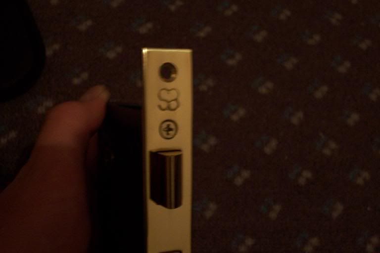

What make ? got a picture ?

Postby skold » 27 Oct 2005 6:09
I really have no idea..ill take a photo.

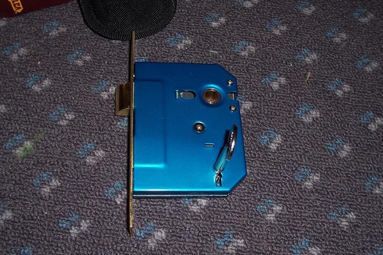

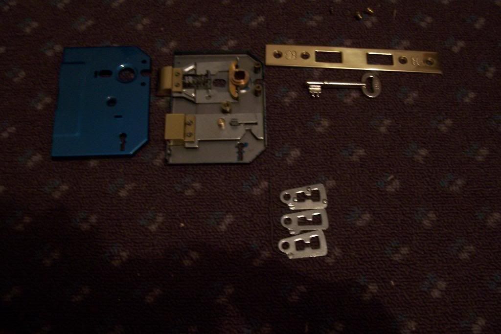

Postby skold » 27 Oct 2005 6:33
See what you can make out of all that.

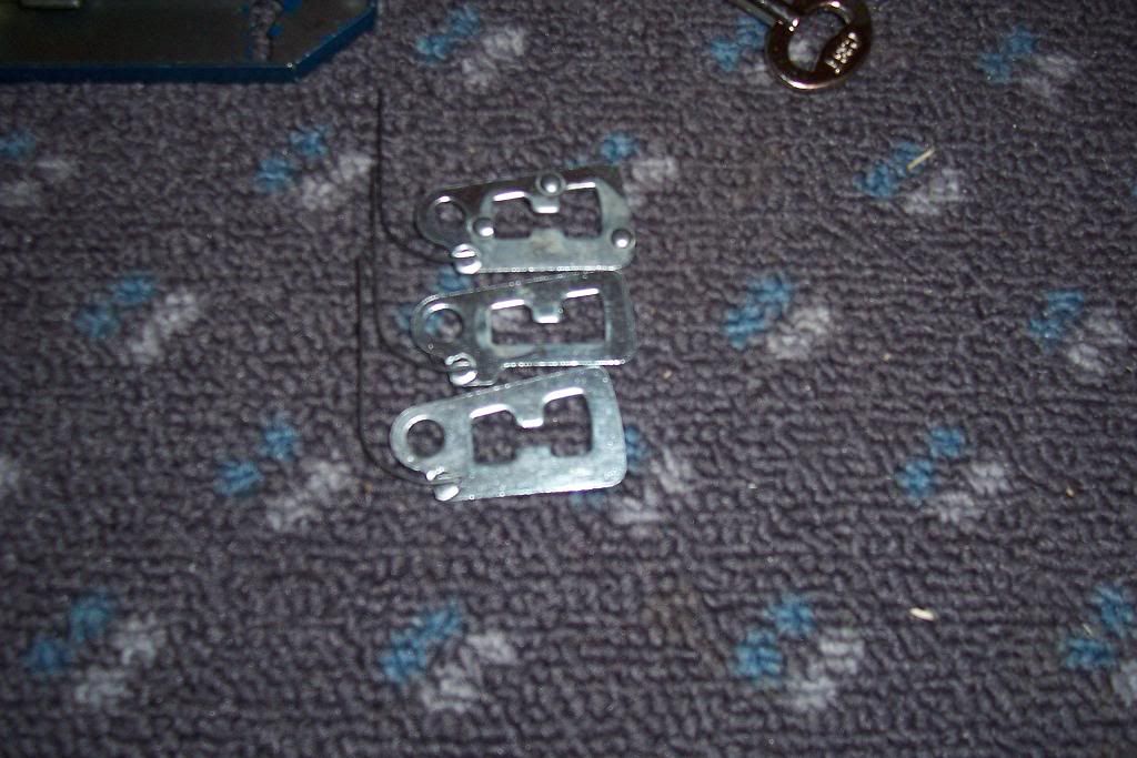

Postby skold » 27 Oct 2005 6:35

Postby Shrub » 27 Oct 2005 6:44
Is it a new lock or one youve tried tensioning by pressing the bolt in quite a lot?
I only ask this as you may have slightly worn the cheap metal of the levers so that they are all biting the same.
Due to it being the bolt stump being not 100% perpendicular to the bolt is why you can pick them a lever at a time, if the above has happened you should be able to swap the levers around and then pick it normally as the levers will have been seated to the bolt stump in their original positions.
If that makes any sence.
Postby oldlock » 27 Oct 2005 6:45
Make is " Superior Brass "
Low grade crap, made in China or India .
Trying applying tension, then lift all the levers together a couple of MM, them pick each in turn. Should not pose any problems.
