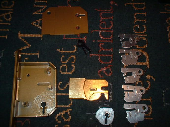

Postby illusion » 9 Mar 2006 18:38
This is what you're looking at seeing inside the Invincible:
I don't know where the photos of my Profit went, unfortunately. The anti pick notches on them should give you an idea regarding what you may be up against. :)
Hope this helps. :)
