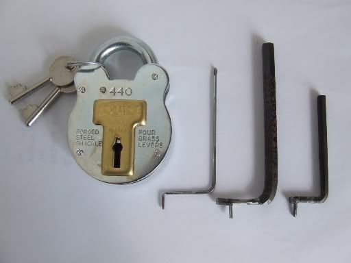

Postby horsefeathers » 5 Apr 2006 7:59
I know they are handmade and look a bit rough - but they work a treat and once inserted in the lock result in a ten second opening.
lever pick wire is modified from one of my wire picks, and two allen keys made the bolt throwers (one heavy duty for those tough rusty little blighters)
regards
wayne

Postby 2hammers » 7 Apr 2006 13:52
Very nice Wayne. Thats another project for me, I never
thought about allen keys nice one.
