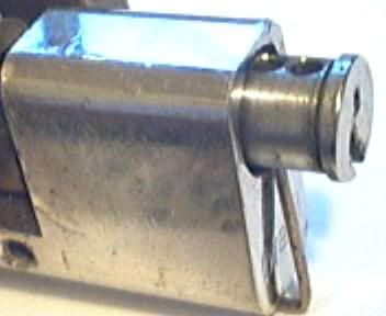

Do NOT take the C clip out yet!
How to remove the core without having a major accident:
Open the lock and turn the plug one quarter.
Make a copy of the original key, then cut the bottom of your duplicate so that the hair clip tool can enter the bottom of the keyway.
Hair clip: You need to make a tool out of a hair clip.
When you make the hair clip tool, make sure that it is long enough to cover all the holes, by measuring on the outside.
Hair clip tool: Sizes may be different on each lock.
Insert the hair clip tool that you have made.
Now, with a little help from the wrench, turn the hair clip tool in place upon the lock.
Take the wrench out.
Good advice: Use something such as a rubber band or tape (in this case) before you remove the C clip (if you use the key, put tape anyway).
You can now remove the C clip!
Remove the tape gently, and pull out the core, but be careful, see that the pins do not fall out, by making sure that the keyway is in an upright position.
The core with the bottom pins.
The top pins and the springs are now secured by the hair clip tool!
When you have finished playing around with the bottom pins, put the core back in, the same way it came out, twist the hair clip tool back on the side, with help from the wrench, and turn the core to a full upright position.
Now, and only now, you put the C clip back on, and your done.

The sawn key is a good trick when you only want to repin a few cilinders. But when doing more than 5 , I still prefer to just put the pins in with tweezers. Once you get the hang of it , it really isn't very hard to do.

just wondering werewolf how many locks have you repinned? Have you ever repinned a euro cyl, cause if you have you would know this method is gonna save you a lot of time and in some cant really be done in any other way

Quite a few actually. A few hundred I think. When I started my collegue showed me how to do it. He showed the trick with the sawn key and how to fill a cilinder with a pair of tweezers.
The tweezers really save a lot of time , over having to saw every individual key. But , now I just pick the lock , that goes even faster :D

I also think it's a good idea to use the sawn key method if you know, you're gonna have to repin the lock several times (for picking practice, etc.). But if you gotta do it once and you don't have a key machine, I don't think it's gonna save you a lot of time.
It's also not very practical if you consider dimple locks, which have two or more columns and rows of pins...for these types of lock I use a different technique (only works for double cylinders):
1. Release the C-Clip on both sides
2. Turn the plugs so that you could pull them out (for simple EU locks this should be about 135°, but this may greatly vary for several dimple locks)
3. Pull out the plugs equally on both sides. Just far enough to be able to remove the cam and its internals.
4. Now you can take small pieces of tubing (with the same diameter of your plug and a length that fits the space where your cam was before) and put them in place of your plug, while you pull it out.
---> That way all your top pins (or bottom pins in Europe) stay in place, which is invaluable when repinning DOM or Kaba locks...
5. For reassembly just reverse the process, taking out the pieces of tubing, while inserting the plug...
Hope I could help!
