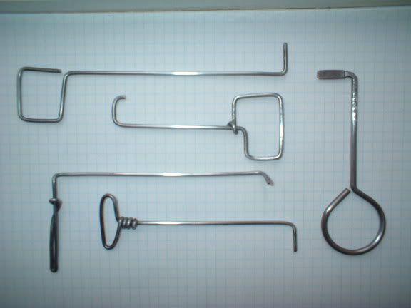

Here is a template of some lever picks:
Starting from top:
Lever lifter,
'J' wire/button hook/overlifter
Another tension wire,
Lever lifter.
The thing on the right is an overlifter, but it's a commercial bought one.
Give the 'j' wire a go. You'll find it works well. :)
Cheers. :)

Postby illusion » 30 Apr 2006 17:57
I edited my post a second before you posted... the scale for the template is 1 square = 5mm in length.
Hmm... try the length I showed... barring that take off the cover and see how long the wire has to be to engage the bolt.
If it's floating, then it is probably too short.
There are othe positions, but I like applying tension like this:
http://i16.photobucket.com/albums/b25/jangofett511/tensioning.jpg
I have a keyway that is wavy and have no trouble in using the picks I showed above.
Cheers,
Ben

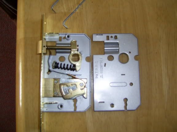

Hey mate. Does the keyway look like this?
Cheers,
Postby 2hammers » 30 Apr 2006 18:11
That's it guys it is wavey, it kind off threw me if you know what I mean. the turner I made was supposed to go all the way in but this lock(my first proper lever) threw me a bit. It sort of threw me that the talon was not on the bottom if you know what I mean.

Postby illusion » 30 Apr 2006 18:19
2Hammers: If you have the same lock as the one I pictured, all the picks will work except the commercial overlifter.

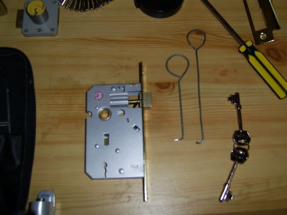

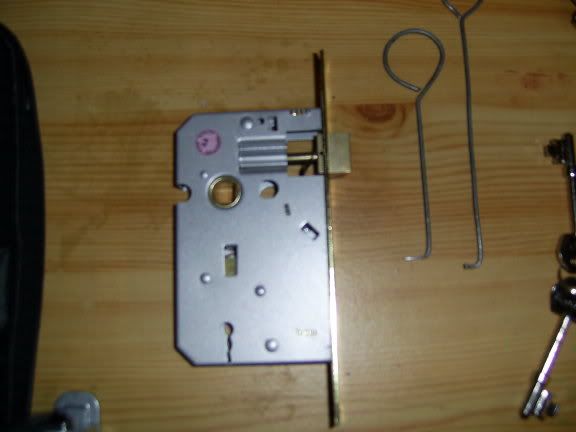

Postby 2hammers » 1 May 2006 10:27
Here are some pics of the lock
sorry about the size i haven't worked out how to re-size yet.
Cheers

Postby illusion » 1 May 2006 10:44
The wires in the template I posted should work on your lock.
I've found that heavy tension on some 3 lever locks works since the bolt is a bit stiff.
You tension wire and lever lifter both look too small.
I know it's like cheating, but you may consider putting a clear cover to replace the front cover - this will allow you to see what you are doing inside the lock and allow to to see how the lock reacts to picking.
Cheers.
P.S: Use MS Paint to resize your photos if you wish, but the photos you posted are ok in terms of size.
